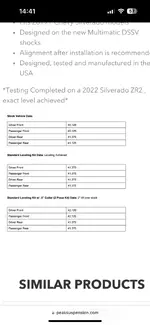

I installed the standard Peak Suspension Spacers which claim to give an exact level of 41.375 front and rear. My measurements do not align with this data. Has anyone measured before and after with this setup?

I received a reply from Peak. The arms they refer to are the Dirt King UC’s.
Well if you did arms, that would affect it slightly because those arms are at a different angle from the factory, and the caster would move the axle forward.
Our test data was bone stock truck with just the leveling spacer.
The spacer thickness does not equal the total lift height. On top of the shock, it's double. On the bottom of the shock, it's .75.
For example, a 1/2" top spacer would equal 1" of lift. a 3/4" collar spacer would equal 1" of lift”
