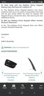

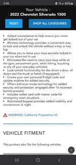

OK...now that more has been posted, I think the info is clearer. Based on what @ZR2NYC posted, the unit is clearly battery powered with a lithium cell that can survive for about 6 years. Keypads use very little energy and draw micro-current. This must just be a transmitter like your key fob. It must be dealer programmed just like a replacement fob so the vehicle recognizes the keypad. Not rocket science and, most likely, just sticks to the pillar with 3M heavy duty automotive tape. If I saw the value in one, I would buy it, but I don't.

also a fun fact.....the internal battery is NOT replaceable. specs say it should last about 5-6 years and its roughly $150 for programming/ install depending on dealer.
