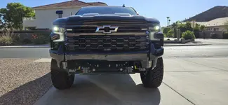

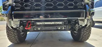

If I was gonna plow, I'd fab up a custom mount directly off the front of the frame where the tow hooks exit. That plastic cover and a portion of the bumper would be easier to modify. If you start hacking any of the other pieces it's gonna cause some issues, because they all bolt together as a system with many fasteners and clips. You'll end up with sloppy pieces that vibrate and bounce.
If you don't want to do that, I'd replace the whole lower front clip with a custom steel bumper that will accommodate the plow.
