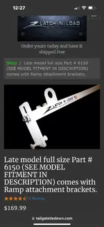

Its a lot of times the bounce of the load, plus worn or rusty cables. Cables are a strand rope and funny how a little water wipes out the lubrication and forces of failure take over. Your weight doesnt sound that heavy. The old 2500 hd used to carry a 500lb rating per cable, I believe that gm doesnt commit to hard number any more. Weak link is cable wear. There are companies that make stuff like pics below. They turn your tailgate into ridged bar connection for those heavier loads that are marginal. It requires both component's. The tailgate tie down does slide in and out if used. 😀 On the flex tailgate it has a little sticker that says 170 kg load. That is at the flex part. I dont think 2 buddies sitting on there going to do anything, but 3 sitting there bouncing down road might tweak it😀
