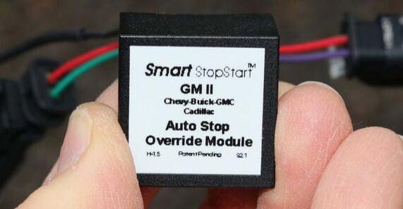

I bought an Auto Stop Override Module from a forum member and it was a simple 5 minute install. 1 plug under the hood by the battery and 1-10mm nut to hold a ring terminal on the negative battery terminal. And it works perfectly. And didn't have to tear apart half of the interior.

Yes....the SmartStopStart module that @securityguy and @The_Q both linked is the module that I bought from a forum member. It is a simple 5 minute instal as I described in my earlier post and it works perfectly.
1 plug and 1 ring terminal right by the battery. And they even supply you with a nut to go right on to the extra threads on the negative terminal clamp, so you don't have to take anything off, and give you a 10mm wrench to tighten the nut. Very very easy to install.

Do not get this one. PITA to install. This one is a 5-minute install in the engine bay at the battery. Much better solution but a bit pricier. I was the first to install this and then many have followed based on its ease of install.

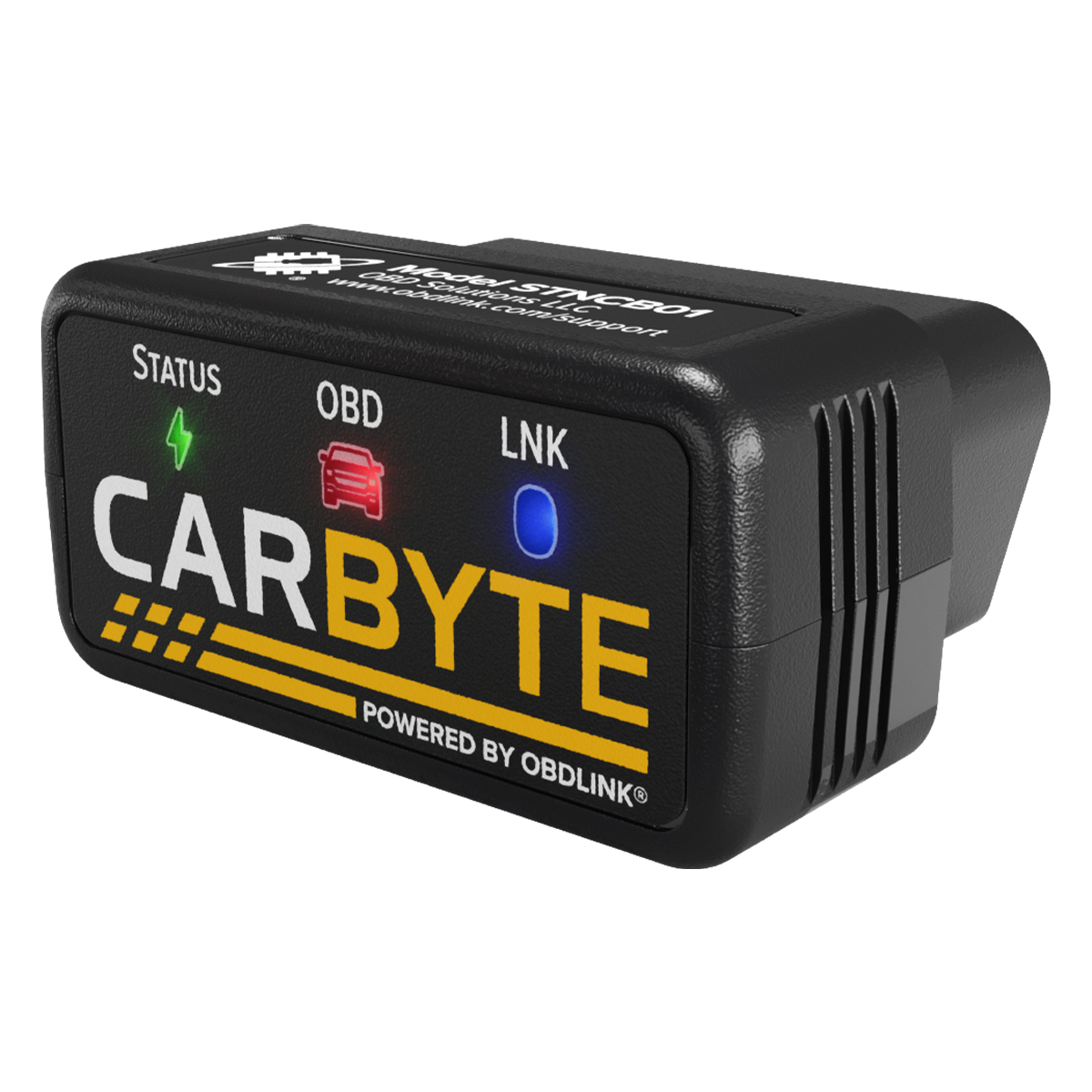

I wonder if the Carbyte would work with the diesel? It’s any easy obd pluggin for the gassers, and also being able to read codes is a nice benefit.
I don’t have a babymax so don’t care enough to contact them but I do wonder.
I don't believe that one is designed for the new ECM architecture.

Update on the SmartAutoStop Module:
I removed the SmartAutoStop Module. The remote start would not work with neither the key fob or my phone with the GM app yesterday morning. And, for some reason, the climate controll wouldn't work properly. Removed the AutoSmartStop Module and everything is back to normal and works as it should. I don't know why this all happened. Maybe the Module is starting to go bad. Not sure. All I know at this point is that with the Module plugged in my climate control didn't work properly and the remote start would not work at all. Removed the Module and everything works as it should.
No big deal. I'll just press the Auto Stop button to shut it off every time I start the truck. These trucks have so much tech and electronics on them, I don't wanna take a chance on screwing anything up. So....no Auto Stop Module for me.

This might be something related to your programming since you said some of your programming was non standard. It may not be compatible with your rig.

You might be right. It might not be compatible. But the only difference is that my truck doesn't have DFM. Just the Auto Stop/Start.
