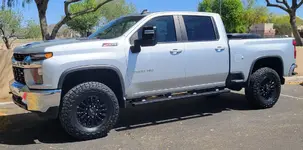

If you drive off road a lot and have to articulate the suspension when the wheels are turned---good luck you will have fouling.I did just Install BFG Mud Terain 37-12.5-18 tires on my stock ZR2 HD rims on a Non Bison Truck . I can confirm it clears the Bumper by 3/4-1/2 inch But that is at the widest point of the tire and at the closest point on bumper if the tires articulate up and down there it should gain clearance . It was rubbing the Wheel Housing liner slightly in the front . I was able to bend the brackets slightly by hand to gain clearance . It may still rub in some situations . Plenty of clearance in the back and to A Arms in the front . I do think 13.5 wide would have looked better but I would most likely need a different offset rim and I wanted to keep the originals . Looking back now that I have seen the bison package in person I wish I had ordered it as well.
Looks good! If you want to gain a little more on front bumper you can crank the torsion bars up a few turns. Also you can trim the plastic for and aft.I did just Install BFG Mud Terain 37-12.5-18 tires on my stock ZR2 HD rims on a Non Bison Truck . I can confirm it clears the Bumper by 3/4-1/2 inch But that is at the widest point of the tire and at the closest point on bumper if the tires articulate up and down there it should gain clearance . It was rubbing the Wheel Housing liner slightly in the front . I was able to bend the brackets slightly by hand to gain clearance . It may still rub in some situations . Plenty of clearance in the back and to A Arms in the front . I do think 13.5 wide would have looked better but I would most likely need a different offset rim and I wanted to keep the originals . Looking back now that I have seen the bison package in person I wish I had ordered it as well.
