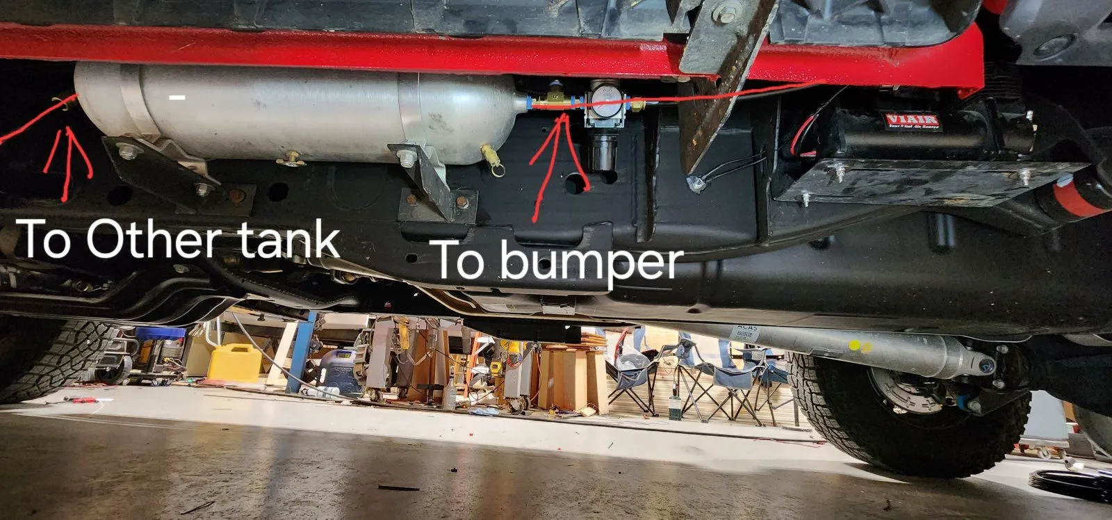

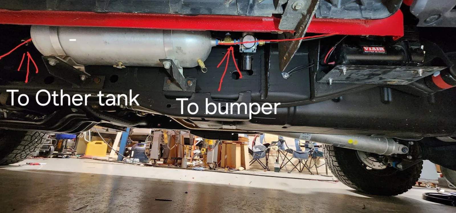

Np, The onboard air is what I was talking about when I said quick connects in the bumper. They were fed from the smaller tank that was at lower pressure. No reason to have 175 psi to them. That's to much for most tools, even tire inflaters. On my truck now I have a similar setup, But I run both tanks at 175. I just have the pressure regulator on the output that goes to the air couplers in the bumper. It basically works the same way. Just instead of the pressure regulator between the tanks. The tanks are just connected with a 1/2" airline and the regulator is between the tank and the couplers. The main upside to this is you have more air capacity with both tanks at the higher pressure. I actually had to do it this way on my HD because there was no good spot to mount both compressors together and connect them to one tank. So now I have one tank and one compressor on each side and a single line between the tanks.
