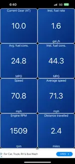

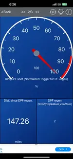

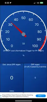

Posting this more as an FYI for those that are curious since I didn’t see much information out there specific to diesels and how much info you can pull. SOOOooo as I save up for a Banks guage to install, I figured I would play around with an old Bluetooth vLinker MC+ OBD adapter that I had laying around. Using the mobile app Car Scanner ELM OBD2 I was able to get some basic information that’s super helpful in the live view, specifically regen info. Sharing some screen shots of the app while a regen was running, after it ran, and some additional data.
