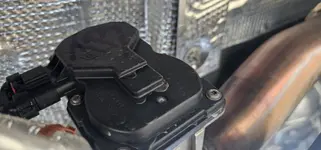

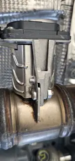

Alright y'all I got up under there for awhile today after I ran some errands and found where it is coming from.
@HighTechPauper 's link that linked something else was correct. It is coming from this module on the exhaust right before the muffler.
Based on the threads I read on other forums this module just makes that sound for awhile but I will go away after around 8-12k miles.
Now I need to figure out what this module does out of my own curiousity.

@TimelordLink, I am guessing here, but based on the description of the junk that came out of the mounting location when he removed it to have a closer look, I am guessing the reason it quiets down after some miles is that if finally gets packed with crap, I will be removing mine occasionally to clean things up a bit to try and keep the soot and whatever the metal debris was from building up. IMHO/YMMV
@HighTechPauper, I think cleaning it out periodically is a pretty good idea as well.... Maybe Everytime I change the oil.
If you figure it out first though I expect a report as well.... My initial guess is it is something do with emissions.
