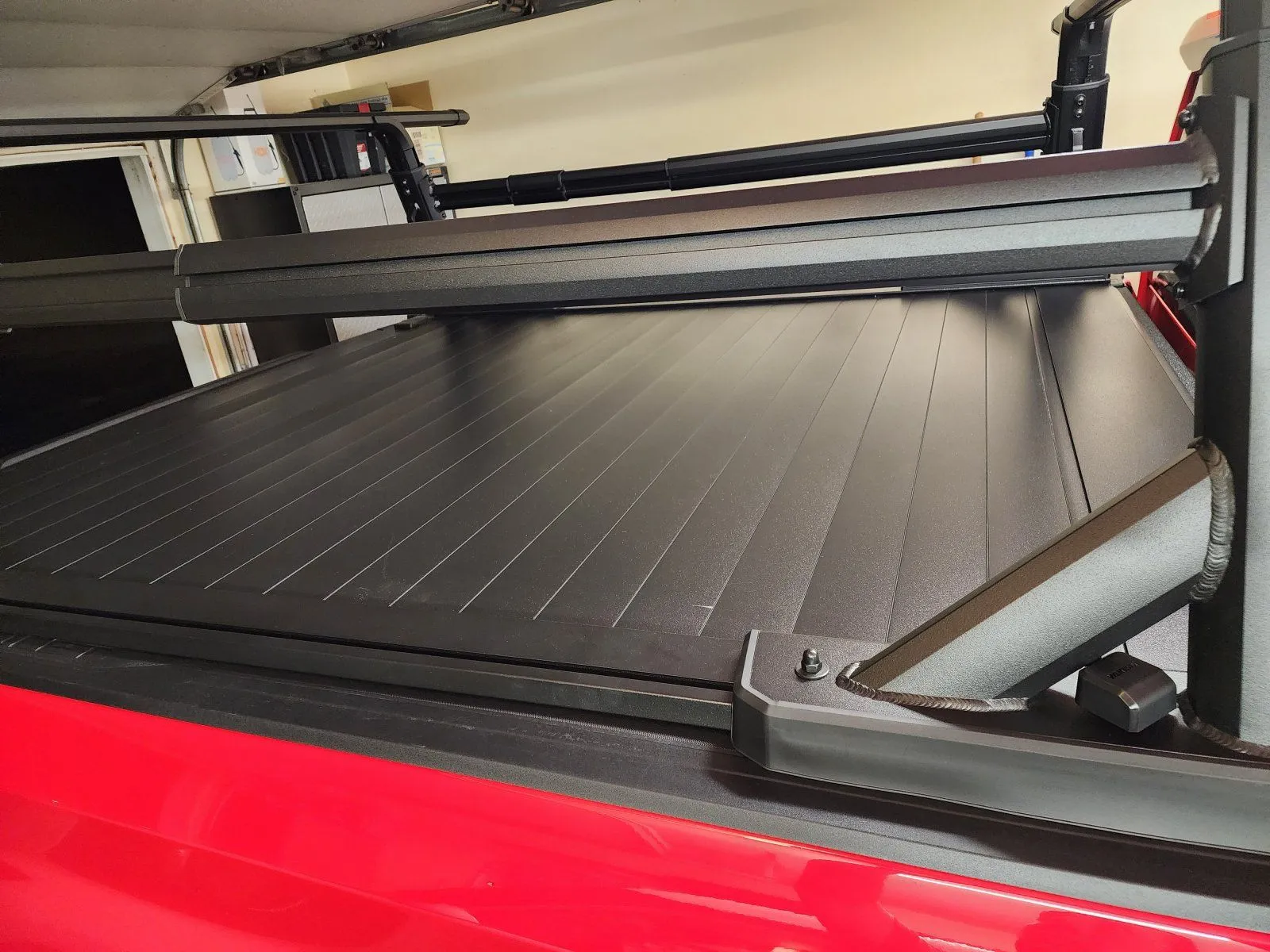

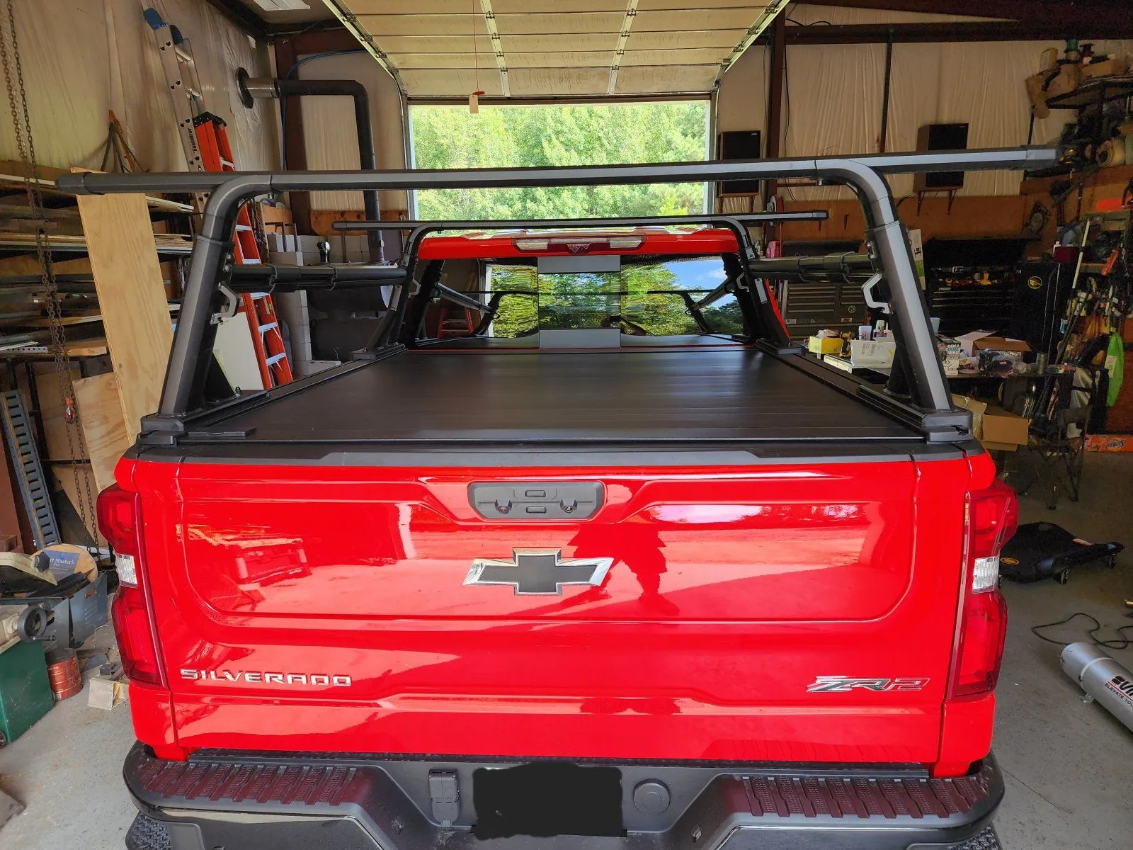

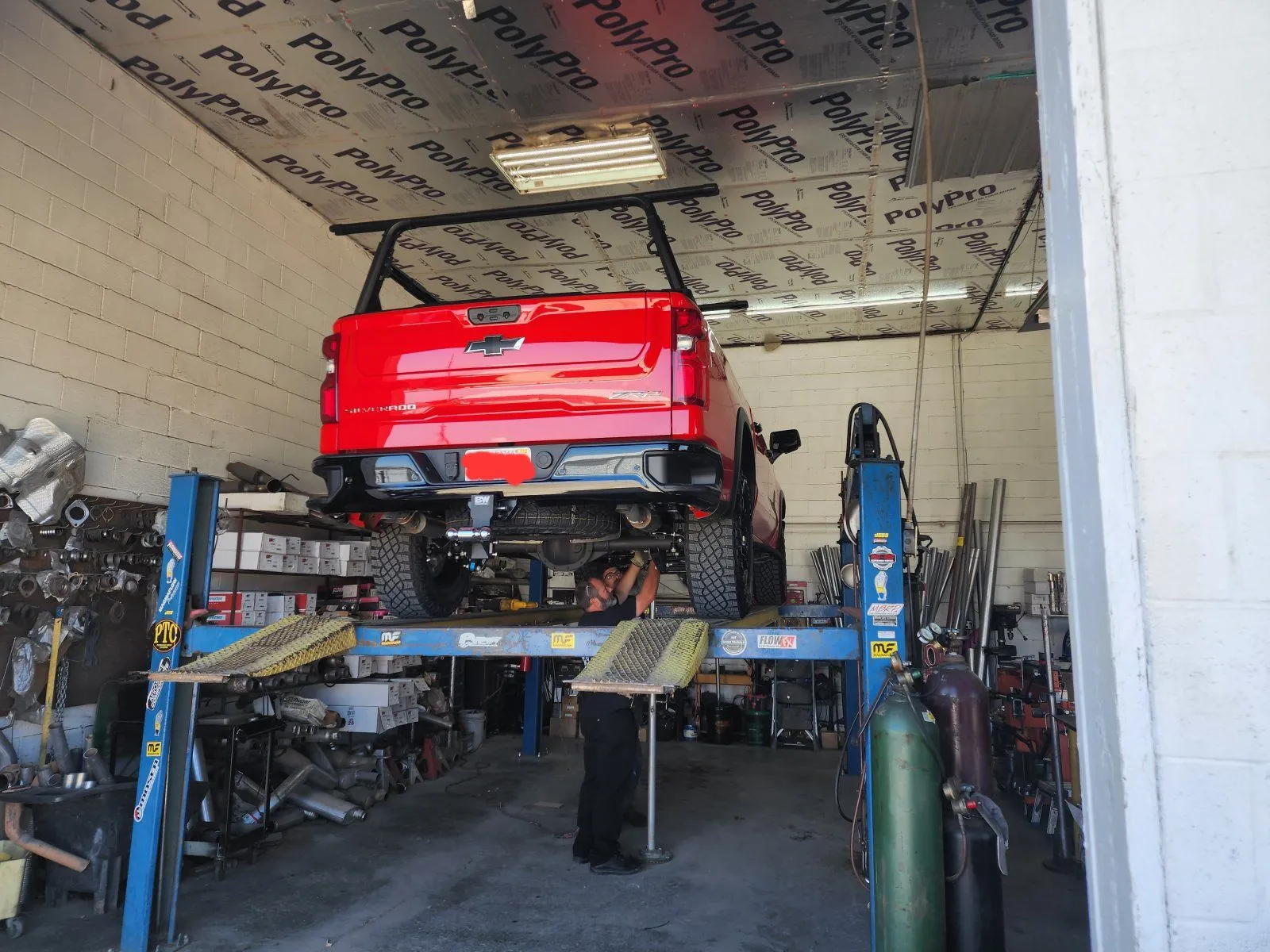

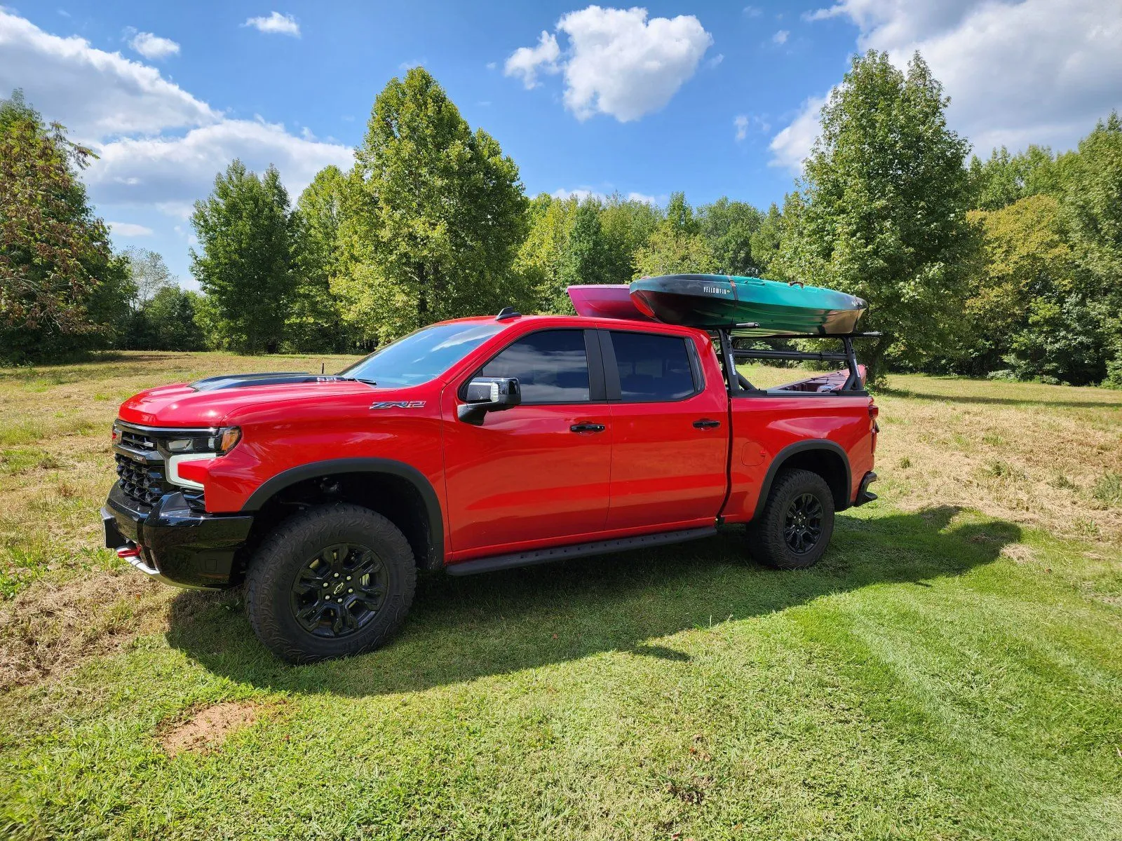

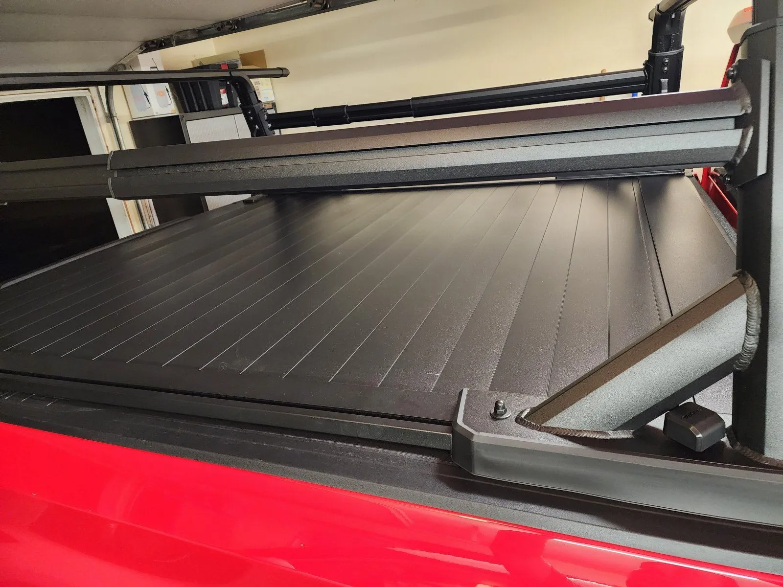

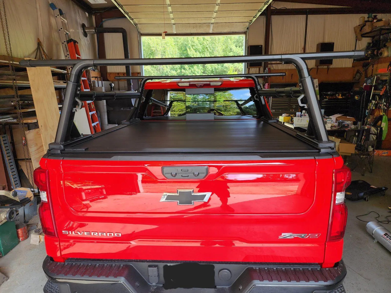

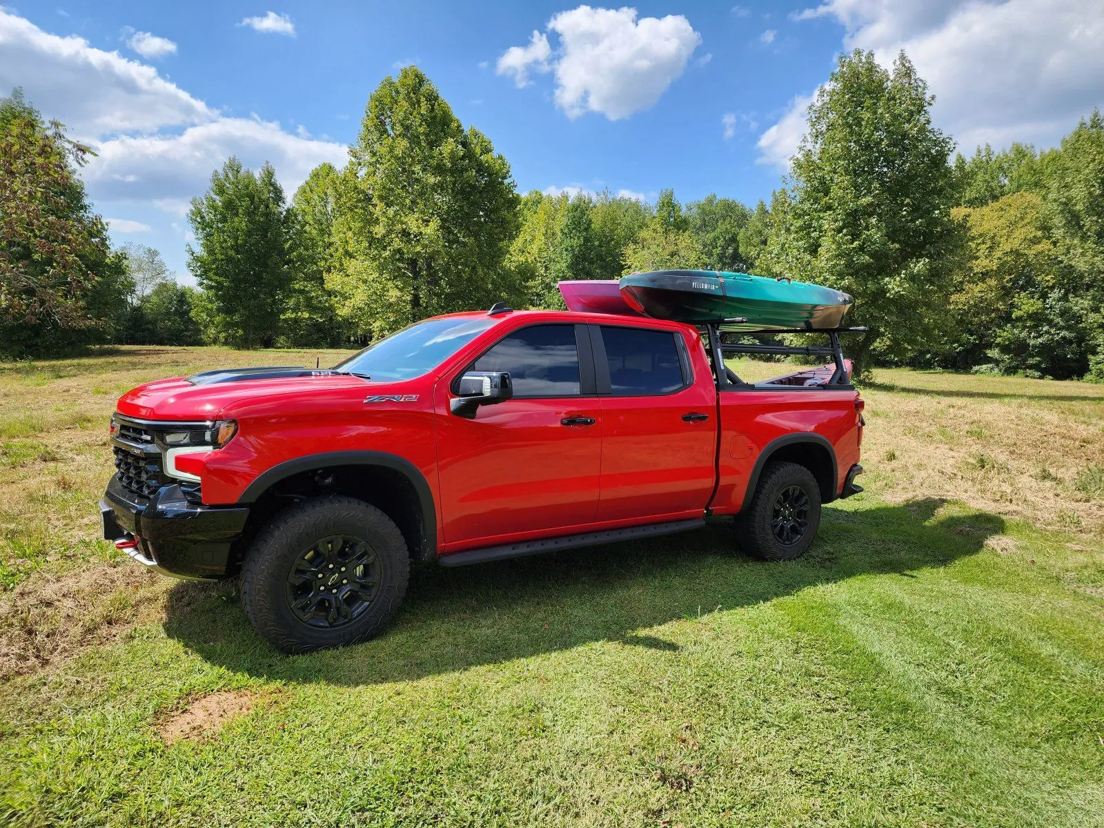

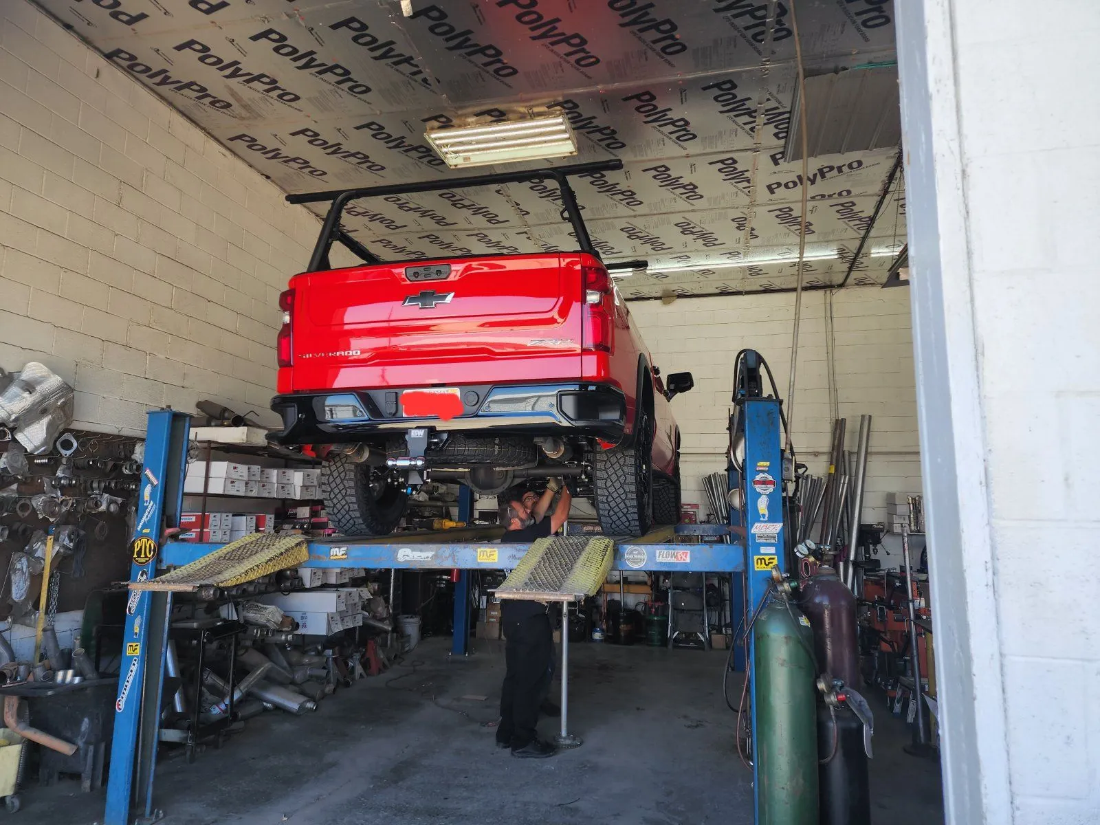

My first mod on mine was the day after I bought it. I put a Retrax pro bed cover and a Yakima overhaul HD rack on. Then I had the factory muffler cut off and a Borla Atak grate muffler put on. I actually stopped by a muffler shop after I left from getting my license plate lol. Also had them tint the windows while I was there. I had already bought all the stuff while I was waiting on the truck. I guess that's not 1st mod, 1st day of mods?

Yes it was Borla # 400844. I think I paid 270 for it and the shop charged me 100 to install. They cut just the muffler and the flapper out added a short piece of pipe and welded it all in. Sounds great less then 400. I seen no reason to drop 1800 on a full cat back.

The flapper is there to help with the helicopter sound when DFM is active. One I plan on turning DFM off as soon as we have a way to do it on our trucks. But actually the muffler shop recommended that I remove it. He said he always takes them out. He said they rust and get dirty and start making noise later. So basically you end up with a rattle and clanking. If you buy a cat back system they have no flapper. They also do away with them

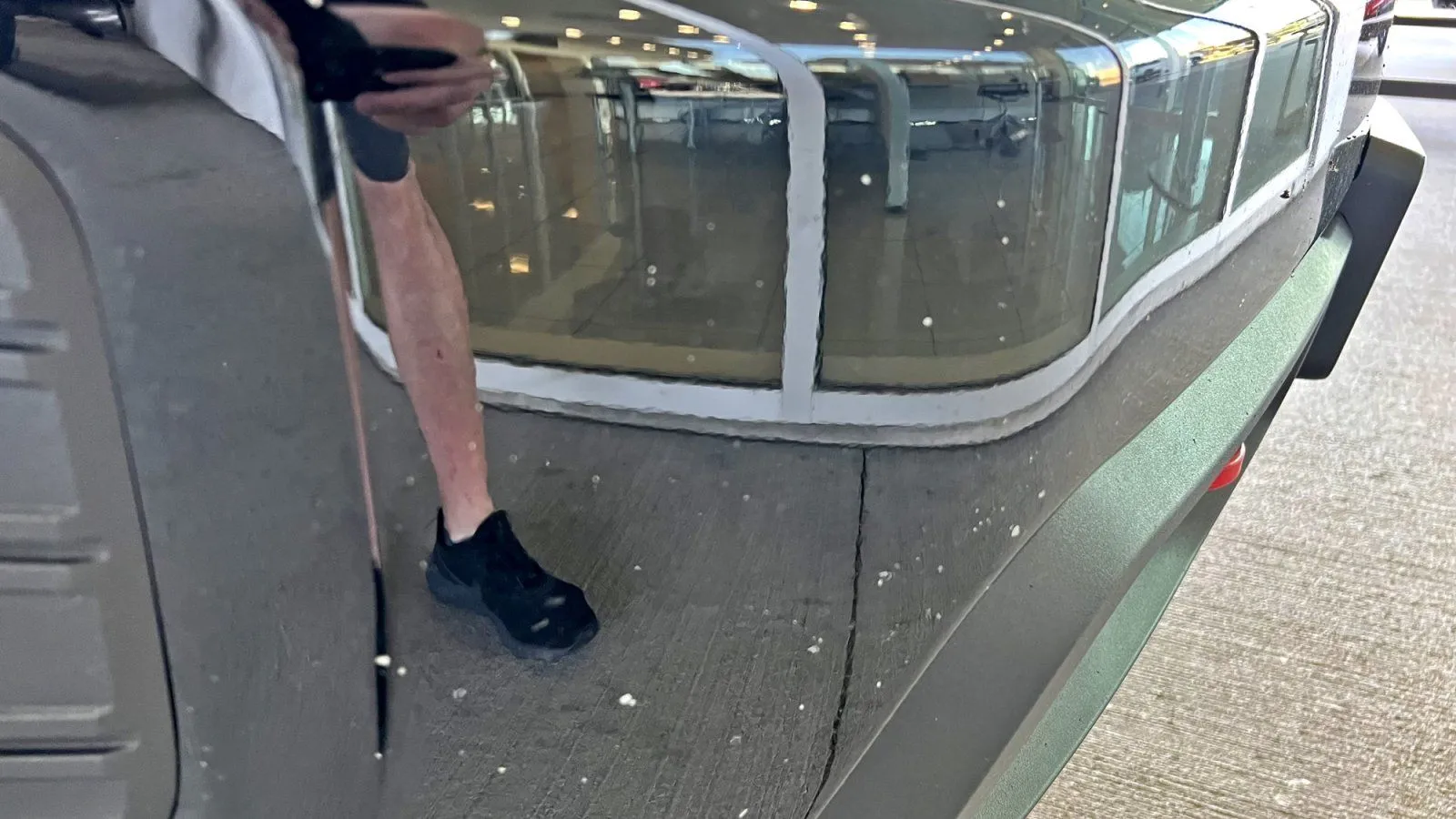

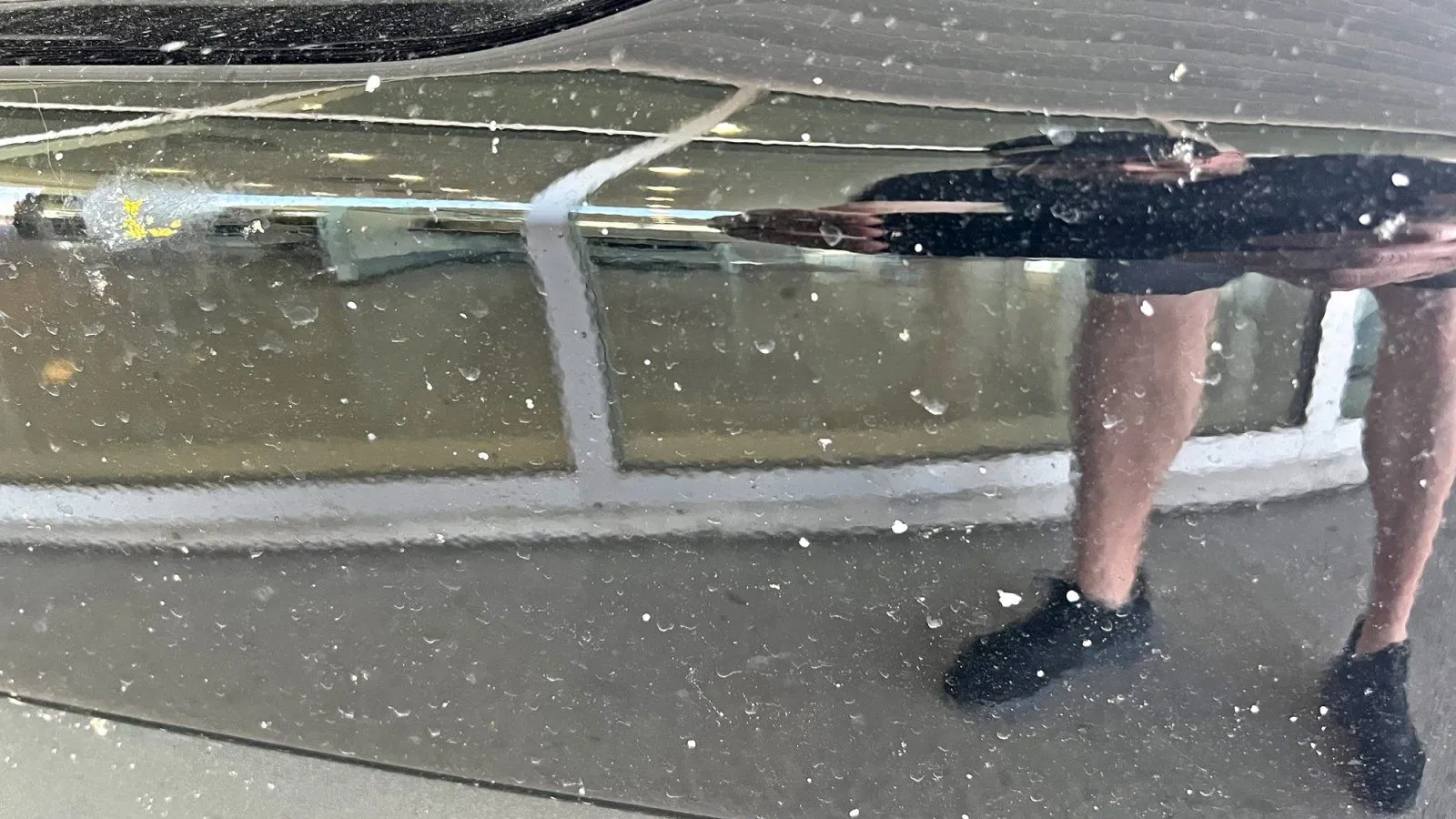

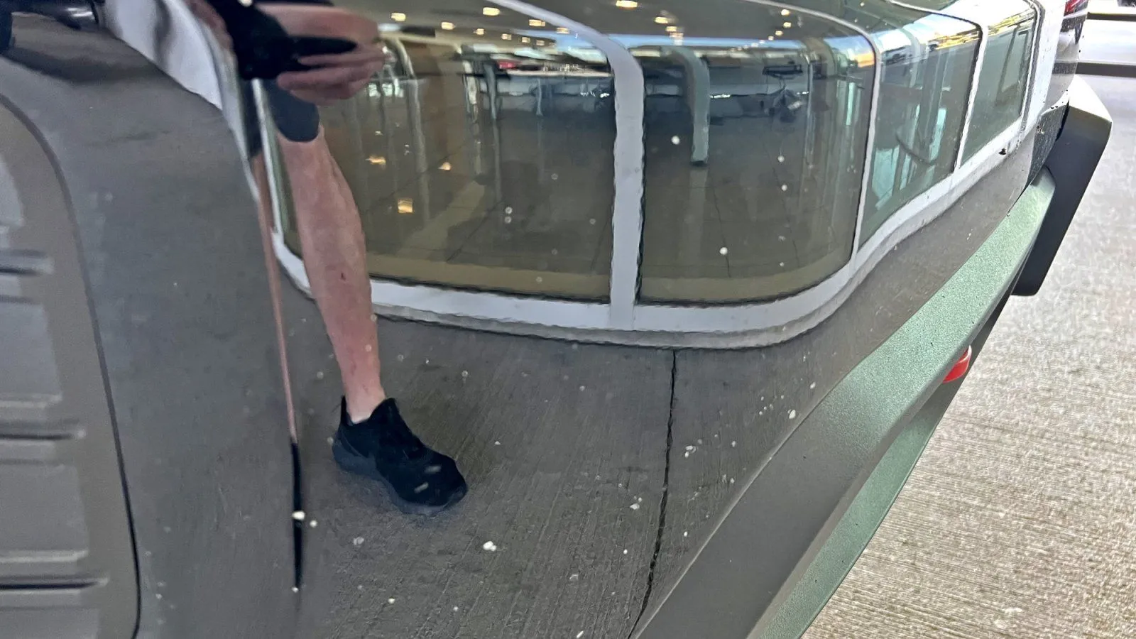

You didn't get the front bumper done? It needs it more than any other spot on these trucks. My Trail Boss front bumper after 20k miles has tons of rock chips. The hood and rest of the truck is still great though. I'm only doing the front bumper on my ZR2.View attachment 857View attachment 858
Hate to see it but looks just like my 2020 Trail Boss. I was actually shocked how many chips I have on the front end from rocks and what not. PPF is definitely something I'll be looking in to for the ZR2.

Can you take a shot of the rack and cover? Looking to install this so I can carry kayaks. Do the top of the cross rail have t tracks?
