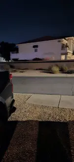

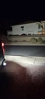

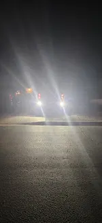

I installed a POD Holes light harness kit with some Baja Designs work scene lights on my 1500 (used the BD Squadron light on my 2500 Bison bumper). Overall, it is a nice accessory that puts out a lot of rearward light as shown in the photos. I do wish there was a little more light right behind the hitch, which is blocked somewhat by the bumper step.
Getting the steps out of the bumper is a real PIA. They have some videos to help, but it's not easy when the bumper is affixed to the truck. Of course I broke a couple tabs, but was able to repair them and they seem solid when reinstalled.
The pod holes are constructed really well, but one side fit a little better due to variability in step plastic on the opposite side. I question if the plastic insert for the screws will hold up over time or if they get brittle from heat and vibration.
