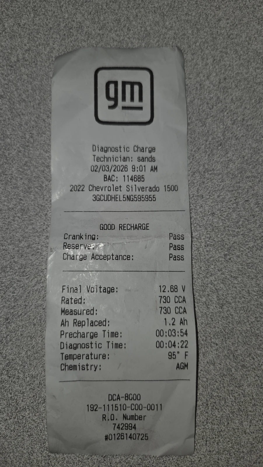

Interesting that I had the dealer check my battery on my final day of warranty. I wasn't having problems, but was hoping I might get a new one. It passed the GM load test, so nothing is replaced without GM approval (they were getting a high number of warranty claims, sontest data has to be submitted).
I bought the truck February 3, 2023 and it was built August of 2022. So I figure that battery is somewhere between 3.5 and 4 years old since manufacturing. I never charge it and it sits days on end sometimes when I'm gone for work or driving my other rig. It has lived through 3 summers with many days of ambient temps well above 110F.
My wife's Tahoe is close to the same, just a few months behind. I'm pretty impressed with this particular lot of AC Delco batteries.
