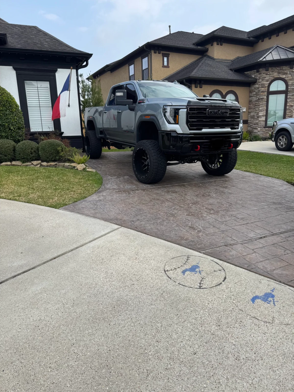

I just purchased a 2026 Silverado zr2 a few days ago and I only want to put wheels that are a bit bigger like 20” or 22” rim. I don’t want to trim or cut anything or lift it. At my age getting in and out of a lifted truck on a daily would not be practical for me. Any suggestions on what I can do ? My son-in-law has a lifted truck and I’ve used it a few time and yes it’s fun at first but got old fast . He hasn’t driven it in months now and it just sits there. It does have I high lift and looks great but not practical.

I’d suggest just leveling the front with UCAs and then your tire and rim choice will be a bit better than stock. Also think about the bumper spacer. That should keep your truck height nice and you’ll fit bigger tires without trimming. Check the wheels and tire thread for more info, good stuff there.
