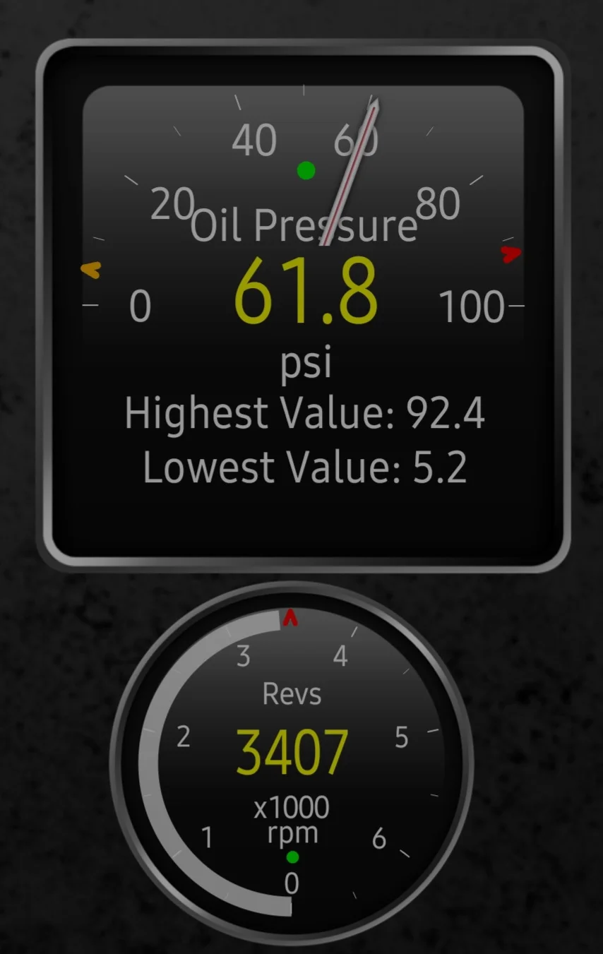

Anyway here's what I was seeing after a few minutes of warm up time at idle With the 0W20 Mobil 1 Dexos oil I have in my 1500 ZR2.
35-45+ psi at idle 600 rpm (higher at start up/lower after warm up)
45-60 psi at 1000-2500 rpm
60-65+ psi 2500-3500 rpm
I also seen some spikes up to 80 psi when I was revving or accelerating to get from 2000 rpm to 3500 rpms, but it would settle down quickly.
Anyway, this seems normal from my experience with GM motors, but I do not know the exact GM specs.

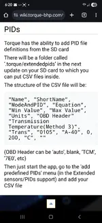

The Torque Pro app comes with a long list of SAE PIDs, but for some reason there is no oil pressure reading. I found this PID information posted on another forum. It seemed to work. You have to add a guage of your choice from their list and then assign the custom Oil Pressure PID information into the database.
