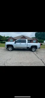

I just put this exact same setup on my 2020 2500 2wd. The truck is stock with 42k miles.
On the 2500, absolutely zero cutting is required with the NV305HD 18” wheels and Nexen 295/70R18 ATX tires.
No rubbing and all the tight spots have at least 1” clearance.
I added a before pic too. The look of those factory 17” wheels just sucked. Total transformation!

Looks great, really changed the look of that truck. Nice wheels and tires always make the truck!
