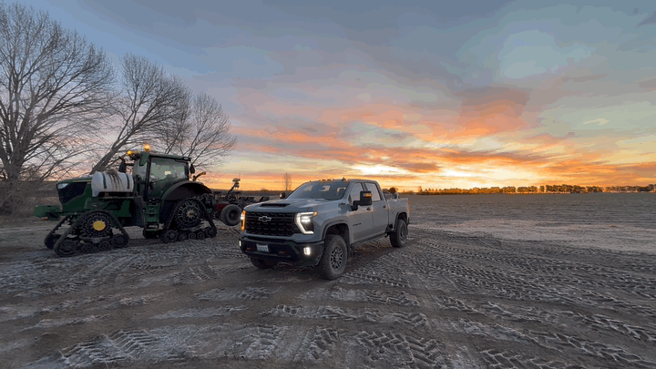

How did you get your lights to do this? I work construction so this would be awesome!
Z wagz flashing module plugs in to you LCM under your steering column. It’s really slick but unfortunately it doesn’t flash the cab lights. I ordered the wicked warnings cab light flasher and will trigger both off of a single upfitter switch. Nice part about this module is there’s no switch required you can trigger it with a sequence on your key fob or by holding the high beam switch for 3 seconds.

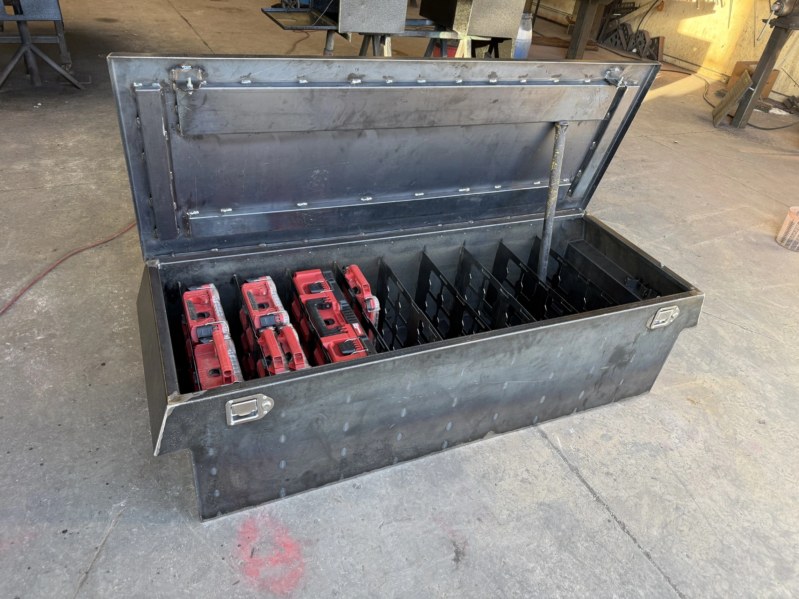

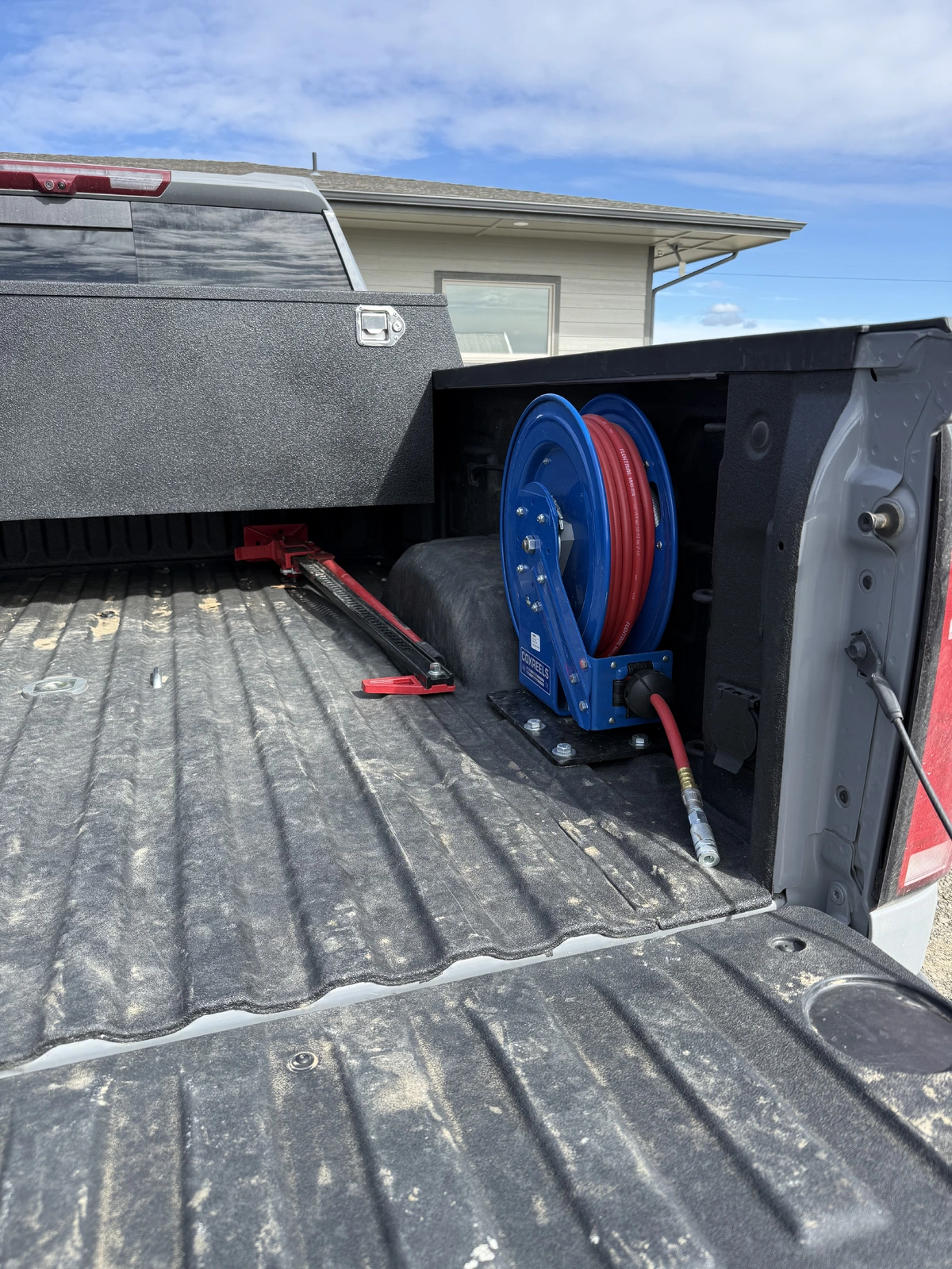

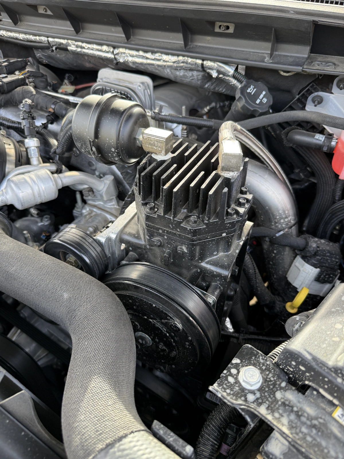

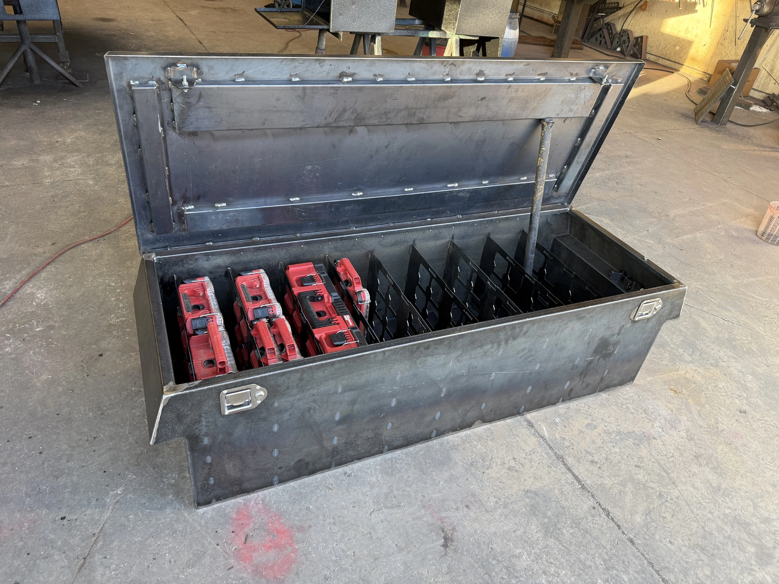

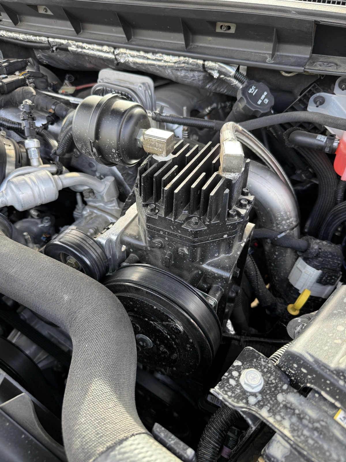

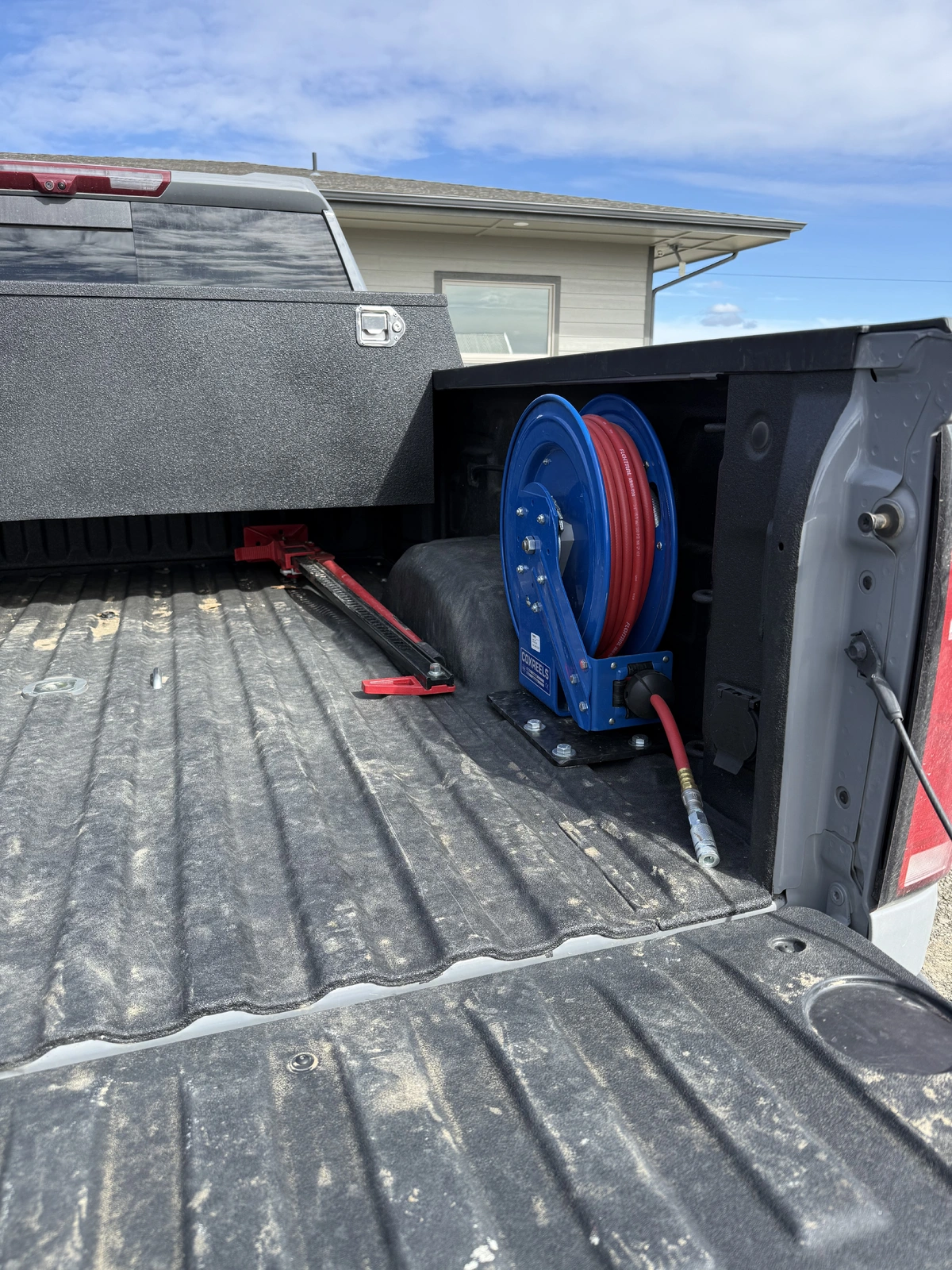

@heavydootyBison since you’re using your truck for field work I got a couple other upgrades for ya. Little shop mfg air compressor mounts in second alternator location and runs off the serpentine belt for 10 cfm at idle. I’ve got it plumbed to a 4 gallon tank on each frame rail under the rear doors, load leveler bags, and a hose reel in the bed. My favorite upgrade though is the milwaukee packout crossbox we built. Holds 9 of the deep organizers.

Nice fab work on that box. Very nice! China can’t build something that sturdy.
