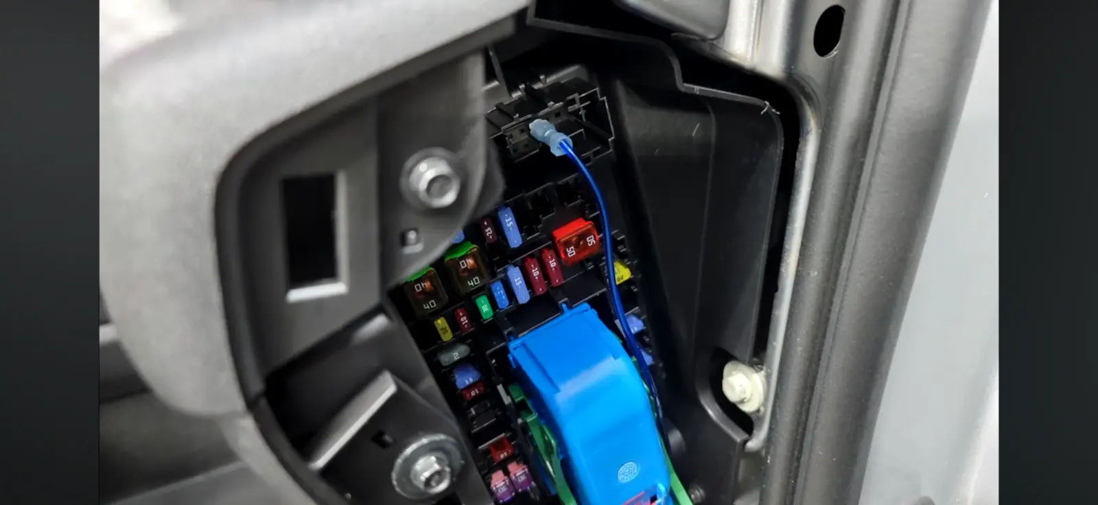

Used an empty spot in the passenger side fuse box for remote turn on. Mounted my bass control knob in the slot left of the shifter. No drilling required to get the wire in there. Pretty happy with the sound now. Big difference from stock but not stupid loud.

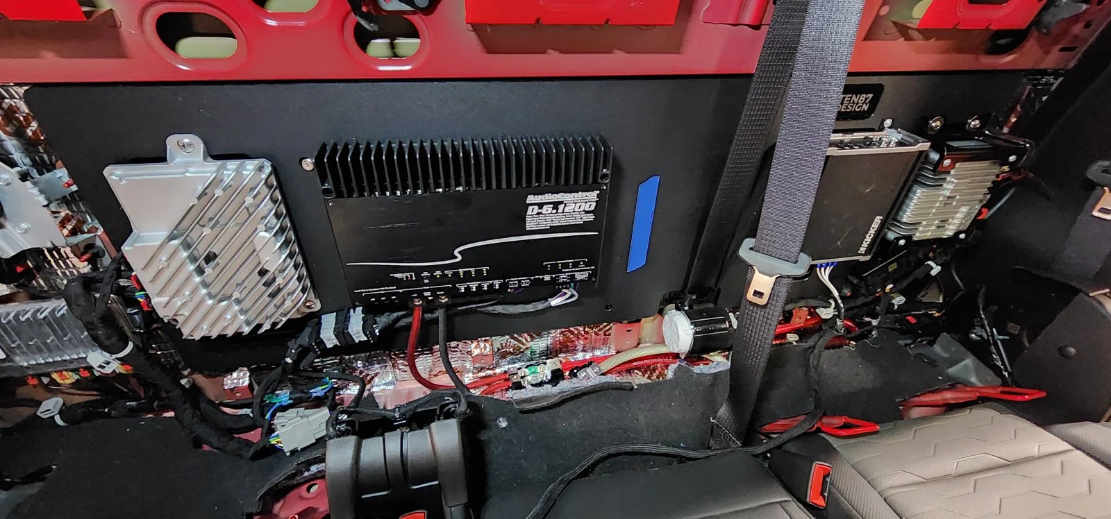

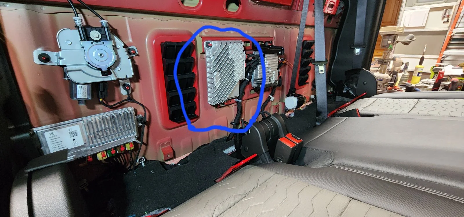

NP, Here is what the bose amp looks like and where its located. It's circled in blue. All the speaker wires is in that harness. The wire harness runs over and along the floor on the passenger side. You could tap into it without removing the back seat. Just pull the carpet forward some to get access. Second picture is after I moved it over and added my own amps.
View attachment 18754View attachment 18755
Thank you. The way you did your install with the black material on the back looks better than the factory install.
