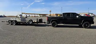

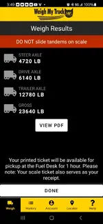

Ask the dealer if you can tow the camper to the scales. Throw a little weight in the bed and camper and see how it sits on the scales.
That trailer and those concrete blocks don't look like much. But they hit damn near 13k lbs.
