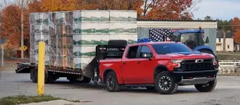

Not me.. Saw this on reddit.

That's a level of dumfuckery rarely achieved, but I just did a 1600 mile cross country run and I seen several other dumbfucks, including "transport and hot shot services" pulling loads made for much bigger trucks rolling down the interstate 75 mph riding on the rear bumper.
Where's Johnny Law when you need him........waiting to give me a ticket for 5 over!
Suspension is out of the equation. That thing is full bump stop smashed. Rear end bearings left the chat.
Yep, exactly. The frame is just sitting completely on the axle. I completely bottomed out my 1500 zr2 with just a 40hp tractor on a 20' car hauler. Sure the setup is a little front heavy, but my previous 2500 and even my HD ZR2 pulls the same setup no problem. If you don't care about the GAWR or having any steering above 45mph. Then that picture above is the way to go, lol. Not real sure why anyone would even install a gooseneck in a truck with like a 1400lb payload.
