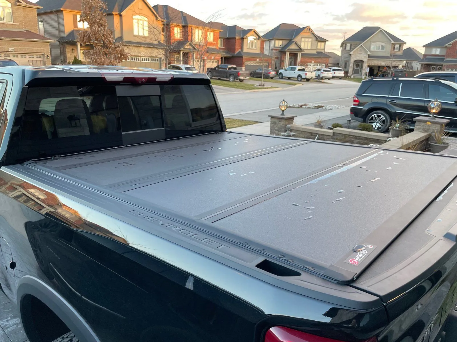

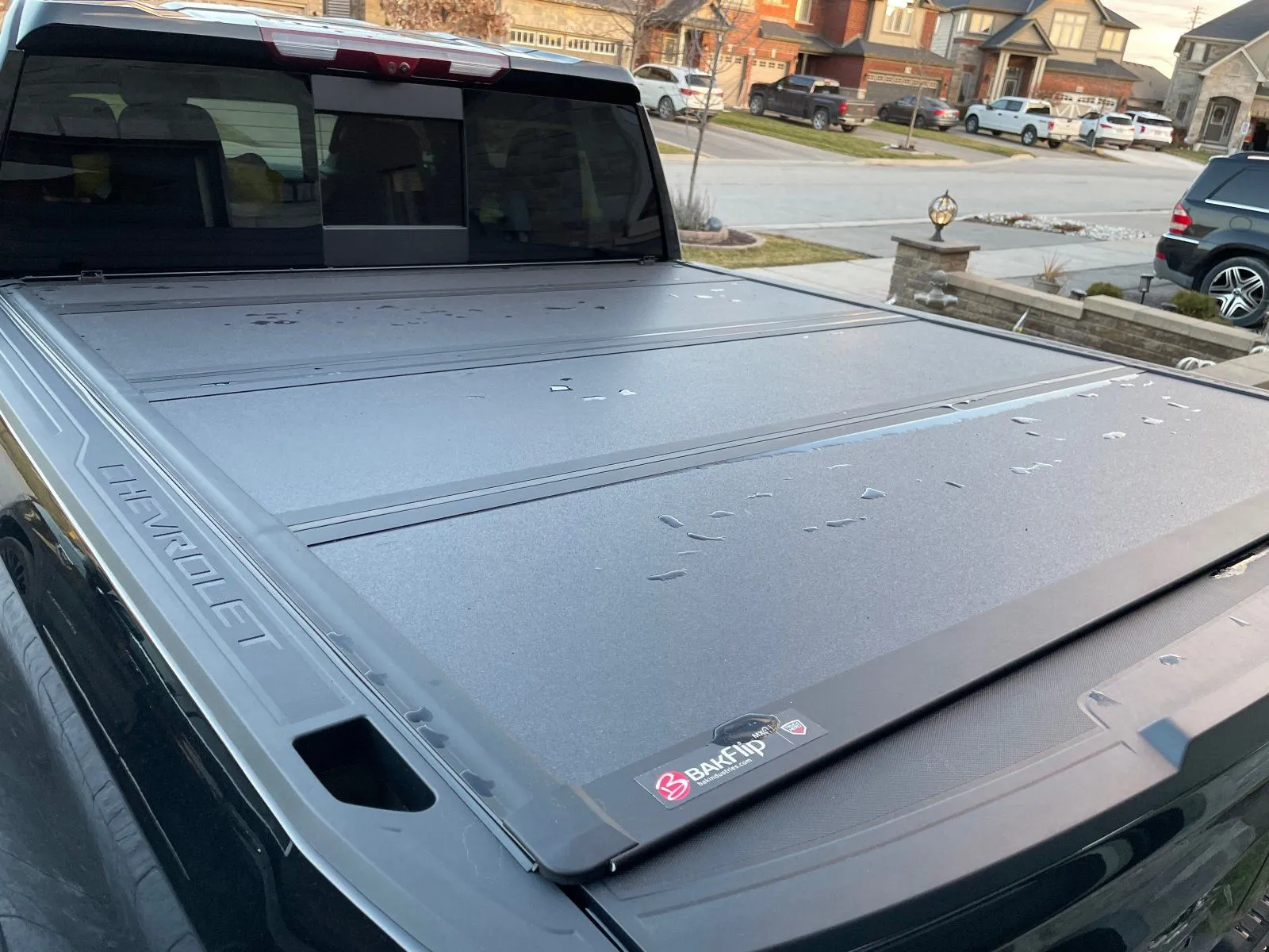

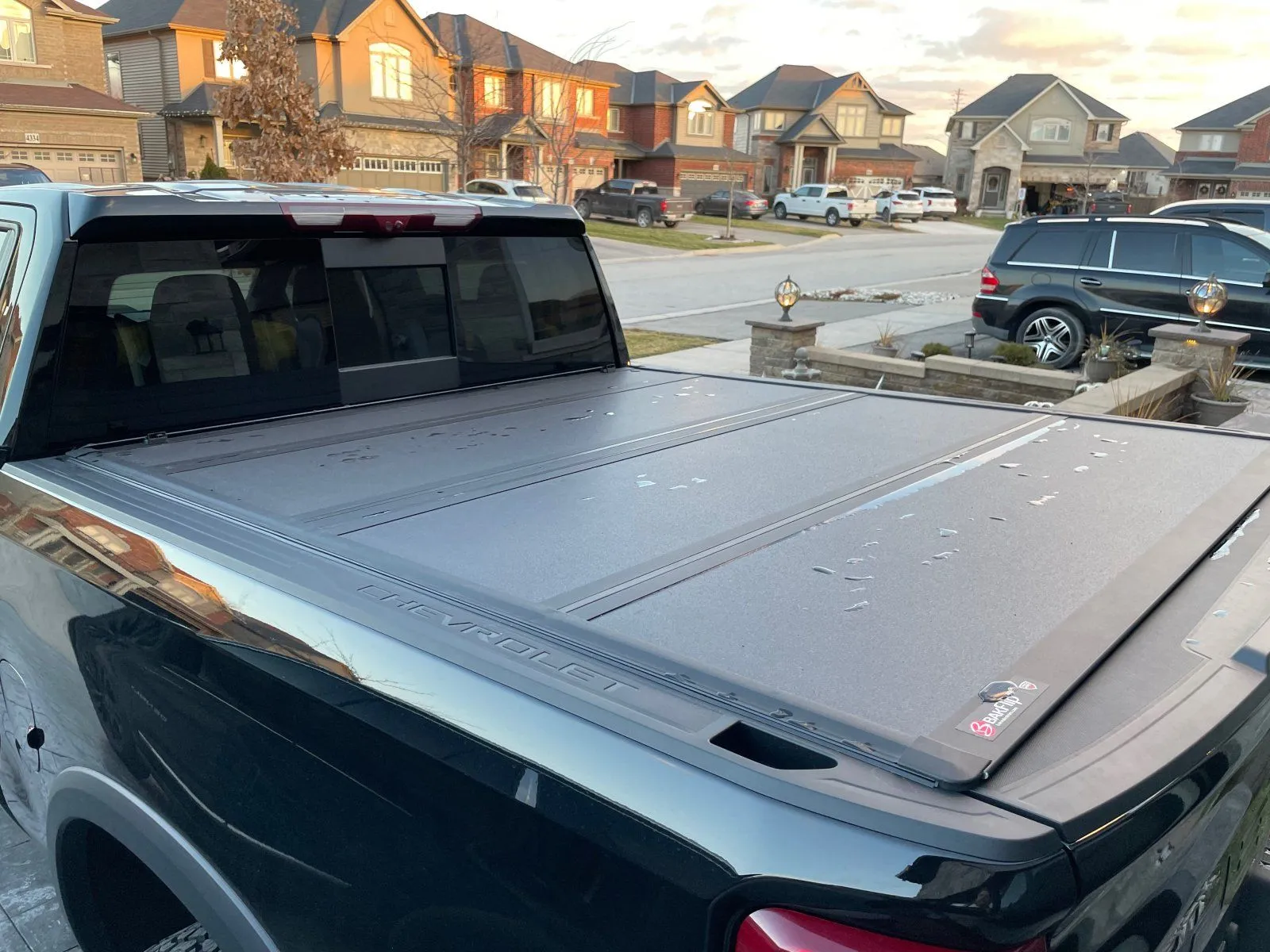

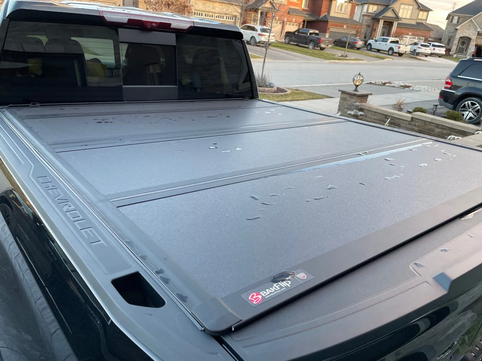

I have the Bakflip installed on mine also. I have one on my other truck (F150) and love it. The only negative I noticed is that when it's open all the way up against my back window, you can't use your cameras in your third brake light
That's why I like the BAK X4S. BAK does make several awesome covers.

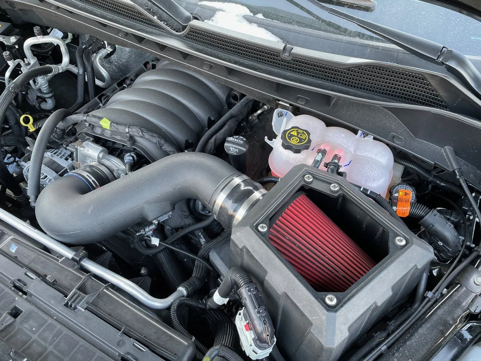

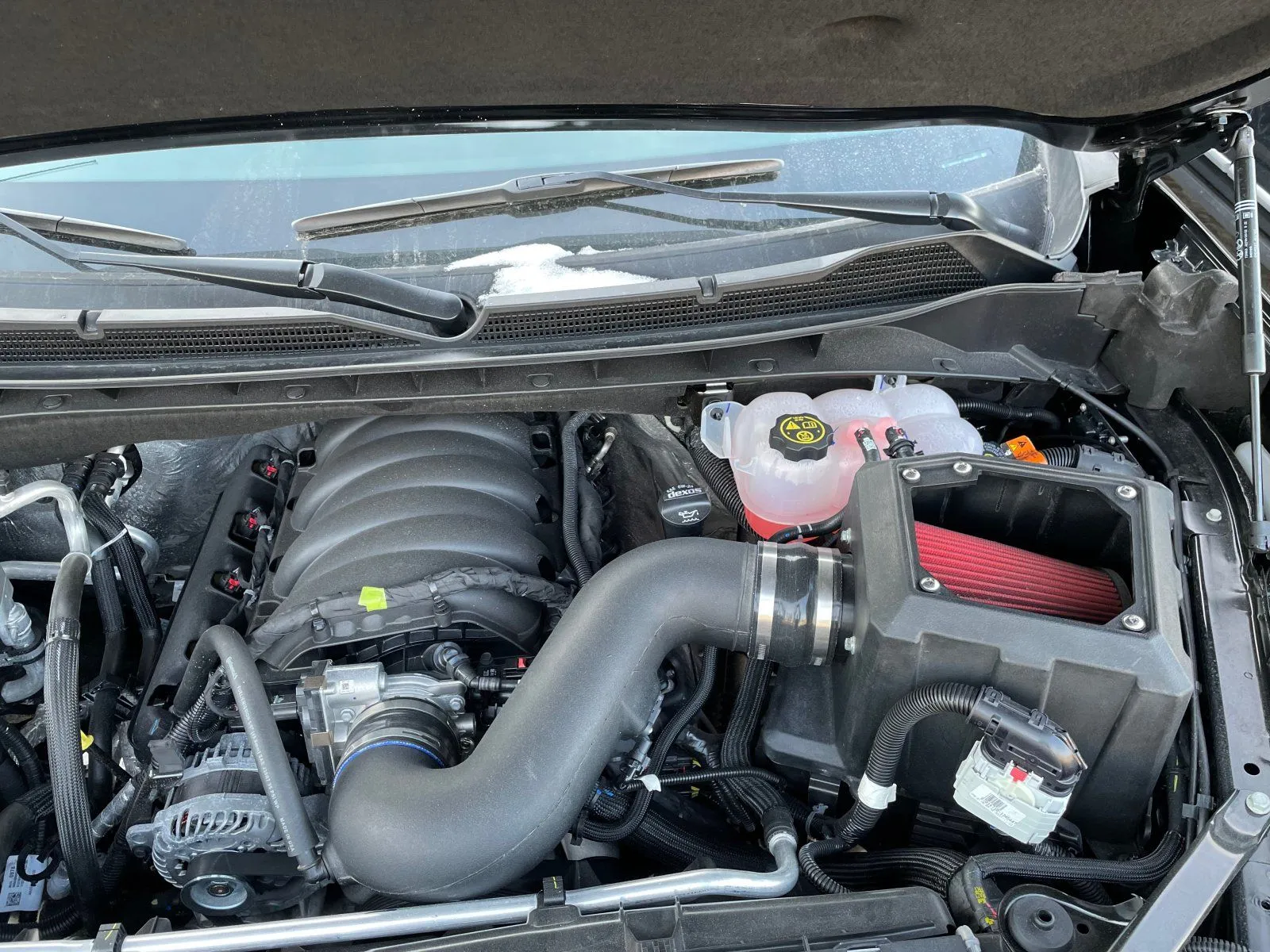

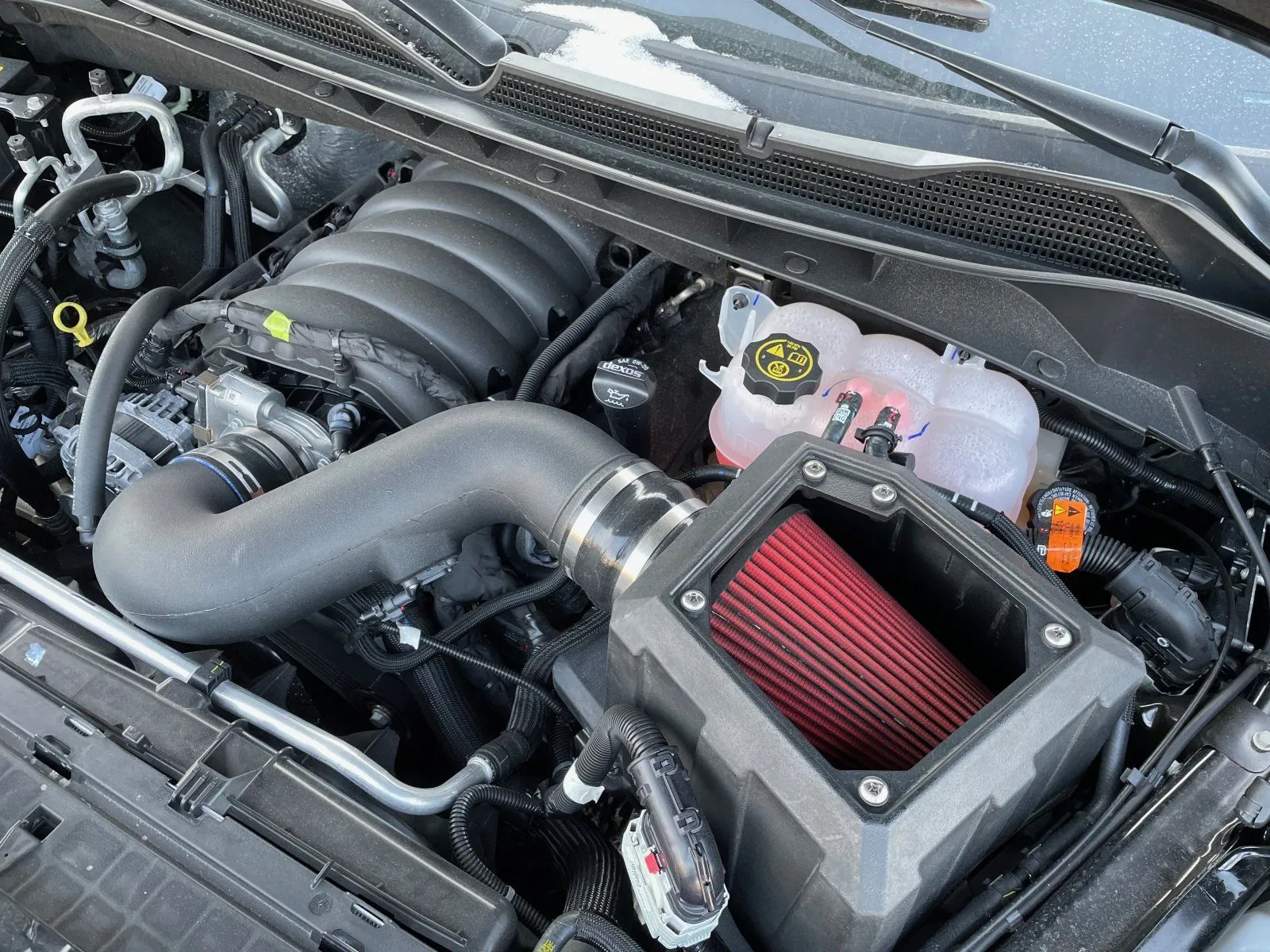

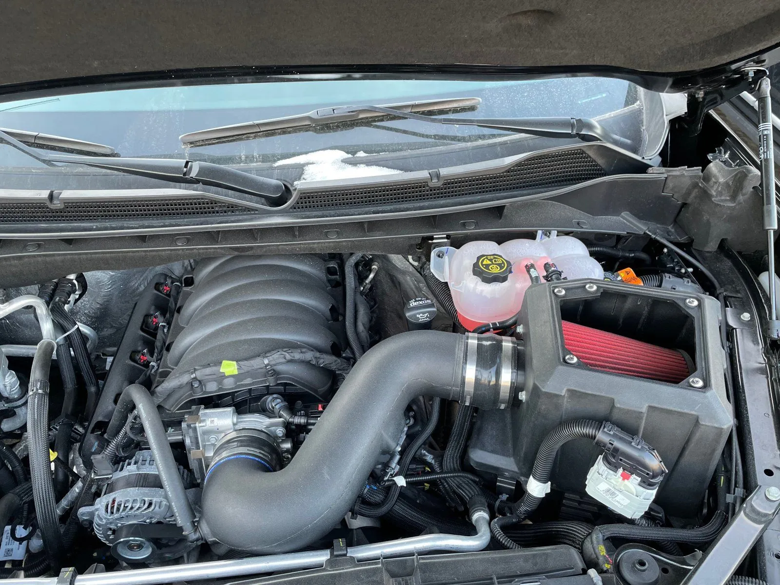

Installed the Corsa Air Intake.
Corsa PN 45954D - went with the dry filter (ZR2 Red). Also, based on a few comparison videos, I opted to remove the fibreglass cover, and run the box "open". No particular reason other than the sound is just better.
Installed, Road Tested, re-checked clamps - good to go. I am impressed with the unit, but severely bias. I have been running Corsa products (intake/exhaust) on a few vehicles I've had. Most recently, the intake and exhaust setup on my wife's Yukon which sounds absurd.

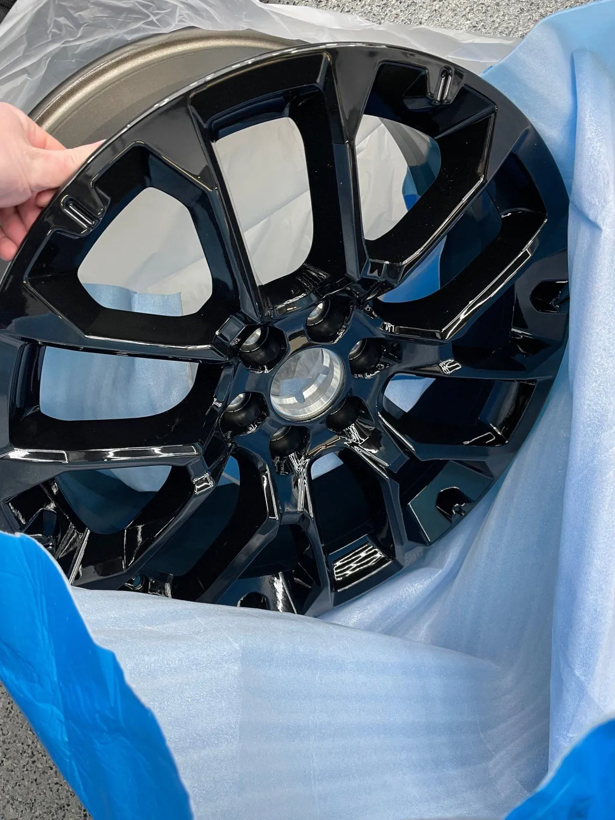

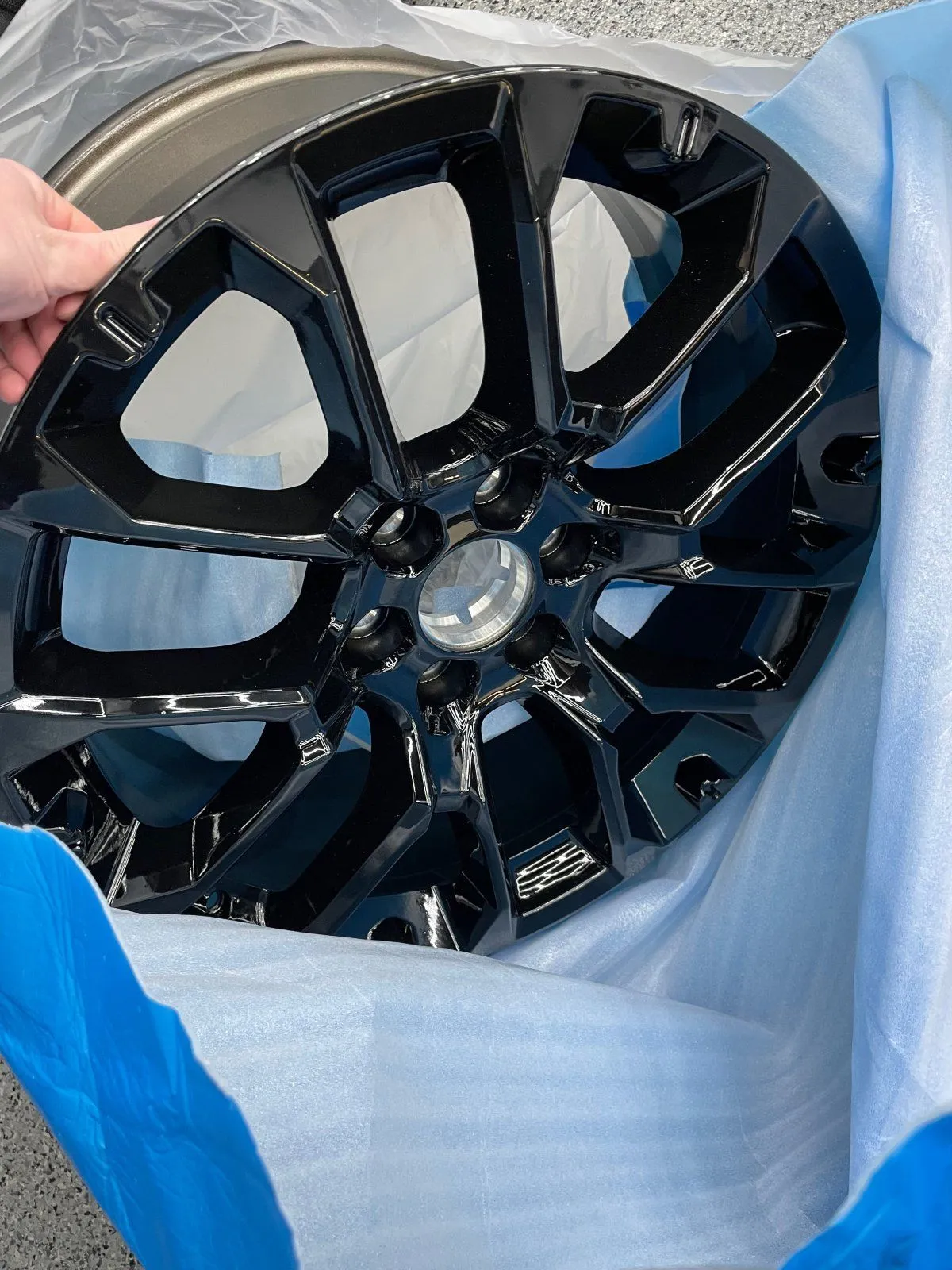

GM Accessories wheels - OEM 22 inch Black Model: 84802386
Been waiting on tires for 3 weeks o_O
Thought for second those might be Voss! Those look exactly like what I want to put on my sand dune. Mind me asking what you paid? Would love to get that pattern in 20" so I can still beat up the trails somewhat.

That will have a negative impact on your motor. You are sucking in HOT air from the engine. It is designed for the lid to be on. If you are only looking for sound, as these things don't do anything for performance anyway, then leave it be and accept the negative consequences.

Being in Canada, I am sure you can find them for cheaper than I did. Just run the part number and see where the best price through a GM wholesaler is. Recommend you stay away from dealer-direct, unless they give you a discount off of MSRP. No 20" option, unless you go to a different style of rim. There are a few black 20" OEM options that are close. 84582671 or 84939095. Just watch your offset for the particular look you desire. Vossen wheels are incredible!

Thanks SG - I think I understand where you are coming from. It will be messing with the air density pulling at warmer temp than the MAF/MAP are anticipating. Haven't noticed a change in efficiency over the last bit of driving. its 3.2(F) here right now so I'm not sure how much Warm air I am actually introducing! lol

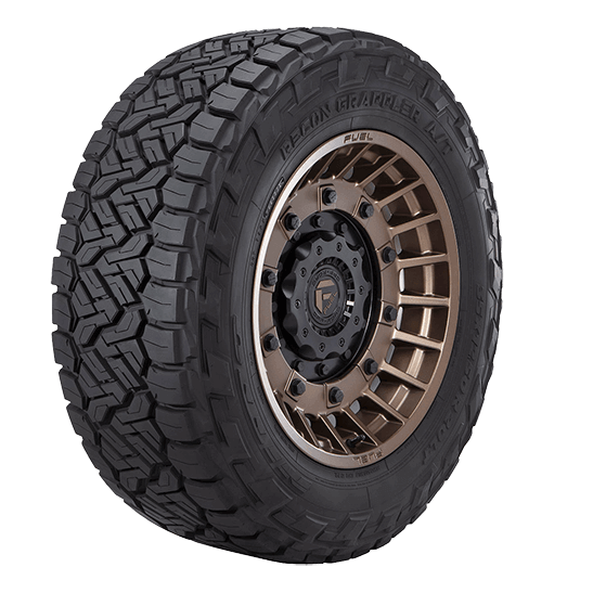

Tires finally came in!
305/45R22 Nitro Recon Grappler AT's [218410]
GM OEM 22x9 Split Spoke Wheels [84802386]
GM OEM XL8 TPMS [84991144]
Only took it for a little spin to verify torque, but it rides very, very nice!
