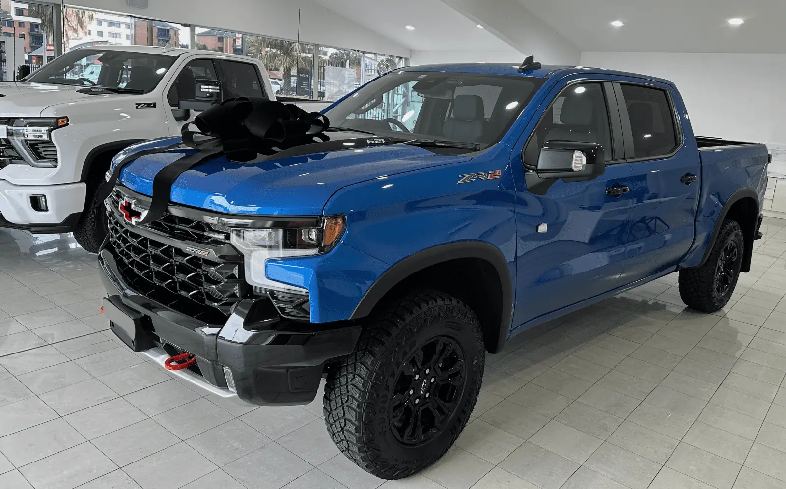

Hi All,
Im Jake, just recently picked up my RHD converted Silverado ZR2 in glacier blue.....what a gorgeous truck!
Early doors though a few little issues, hopefully all fixable/not serious.
1. Driving back home from dealer, about 100kms on the clock (trying to vary speeds and loads etc for run in) i noticed creaking/light knock from the rear end like my springs were made of timber... also felt a little loose in the rear. Only experienced when going over speed bumps or driveways.
