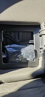

They ship with a radiator cover in the rear seat storage panel.

I would recommend installing it if driving in inclimate weather. It would be interesting to see if it fits the ZR2 grill since it's different than the standard 2500HDs grill tho.
