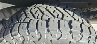

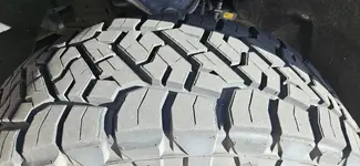

I cross them when I rotate and haven't needed to rebalance them. Here's some pictures of front and rear tires at 10,500 miles. You can see some wear on the outside edge if the shoulder lugs, which is always present on big tires with offroad lugs. Also you can see there is hardly any trend wear, as the little lip on the surface lugs is still there.

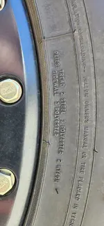

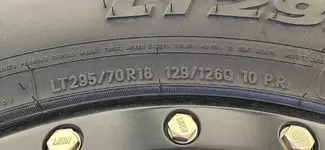

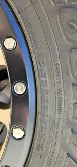

Here's the tire specs from the sidewall.

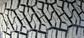

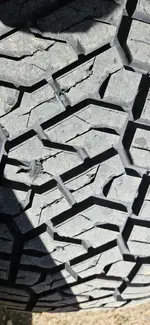

A little different story on the 2500HD. I put these on my old truck right before I sold it to my boy. He's been running these in Dakota. While there's a lot of softer soil and milder terrain, there are a lot of gravel farm and county roads. The gravel is not sharp, mostly rounded. I am seeing some chipping of the rubber on the edges of the lugs. So not as durable on the 9000 lb 2500HD trucks. I'm sure that extra weight is just a little much for softer tire compound.
They are not 3 peak rated, but he said they did fine in the snow and packed roads.
I was thinking of putting them on my 24 2500HD, but not sure I would run them again on an HD. Could have been just that batch of tires. I did see some chipping on one set of my Toyo MTs.
