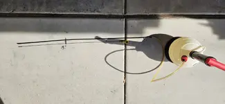

No satisfaction from Pela on this change. I stuck the pickup tube into the dipstick and it bottomed out well past the length of the dipstick. However, based upon the angle of the dipstick entering the pan, there isn't really a path to the bottom of the pan. Perhaps it would work if you had a really flexible hose that would bend down.
I guess if you want to get every drop of oil you have to buy a pan or have a bung welded to the outside of the pan, which is how it should have been done by GM.
