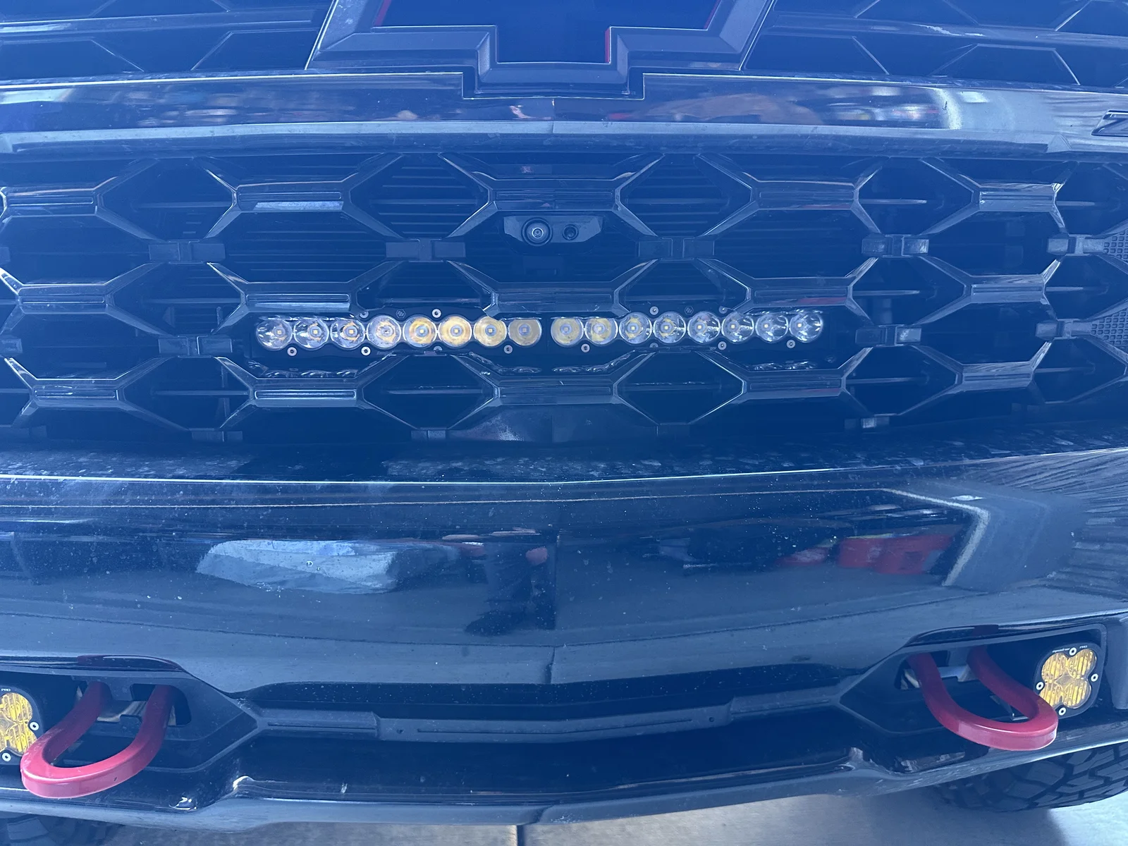

I was able to complete my lighting with a BD S8 20" spot lens behind the grill. I don't think a 30" will fit right and the OnX6 is too deep I believe. It went a bit easier than expected, bought a shit ton of different brackets and metal from Home Depot. Ended up using the 8" "L" brackets in the pics. Had to cut them down and drill mounting holes, paint and install. There are two dog ear metal tabs from the bumper under the rubber flat air flow piece. They work perfect to attach the "L" brackets to and the width fits the 20" light bar. I attached the light bar directly to the bracket and I was able to center the light within the second row up grill spaces. The grill fits back in place and the only securing tab not clicked in is the lower center one because the lower edge of the grill hits the bracket. You could possibly turn the "L" bracket 90 degrees so the grill can connect into the bottom tab and use the light bar mount, attaching that to the bracket. The grill is fully secured and all the other tabs clicked into place. I'm happy with the outcome since I haven't seen any other options for mounts short of the M&R light bar which I don't think is the quality of BD or Rigid.

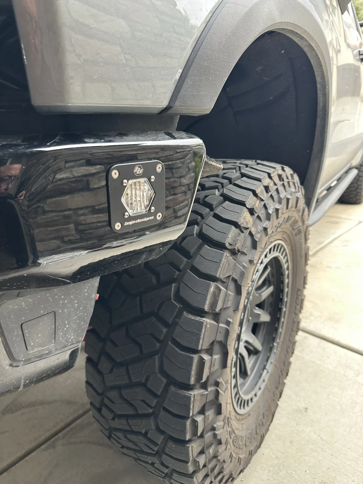

How did you mount those pods next to the tow hooks? Just right into the plastic?
No, I trimmed out the plastic to fit the base of the mount then drilled through the skid plate top edge for the bolt. Had to trim out behind the light for it to set back a bit.
Do you have any pictures on how you did the install on the lower squadron lights?

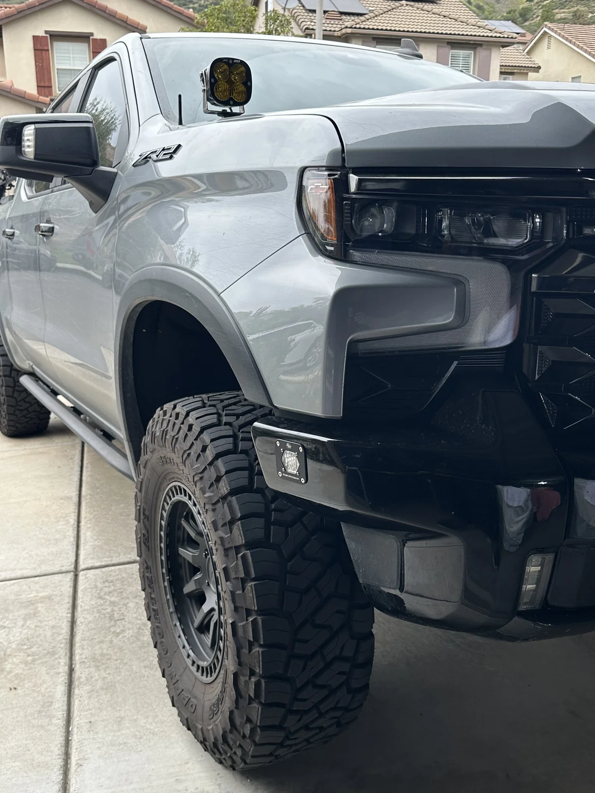

Unfortunately I didn't take any pics during the process, very selfish of me lol. I can say that we've learned our lesson when it comes to the front bumper and such. Just pull it, way less time consuming than monkeying around trying to ET your fingers in for clip removal. Have done it twice, once to replace the corner metal end cap (dented hitting a metal chair on the frwy) and then once to install those lights. You can't get the angle right to drill a hole for the mounting bolt. (You can tighten it once in). BEFORE you pull bumper and drop skid plate to drill, hold the squadron in place next to the recovery hook, you can see behind where you need to trim out. Use a sharpie and draw outline behind to remove the metal and plastic so the light sets in. It's not much but keep putting the light in place and see how it sets back. I remember you can only cut so much because of a brace in the area. It's enough to set the light back, mark the hole for the mount and then remove it all. Lastly, tighten the OUTER two hex bolts to secure the light to the bracket, then lightly tighten the two inner bolts. You can tighten those after install and assure your level on aiming, but you can't reach the outer bolts anymore once you mount the bracket. I used the wide cornering lens which worked great to cover the entire front area. They will angle slightly outward which is fine, goes in to the ditch area while off-roading. I use the sPod app to dim them so I can get away with using on road. Sorry for the long explanation but its tough to detail how it went. If you want to chat about it, pm me and we can talk over the phone. Maybe it'll help and I can send some pics when talking to further explain. Good luck, it's worth the work!
I took a couple pics to show the cuts behind. The cuts can be tighter, I have extra space around. I cut the bottom plastic piece where the mount goes and then added a small piece of aluminum. prob not necessary, could mount on top of plastic. I can't adjust horizontal angle, it's wedged between side and recovery hook. Slight vertical adjustment only. Hope this helps.

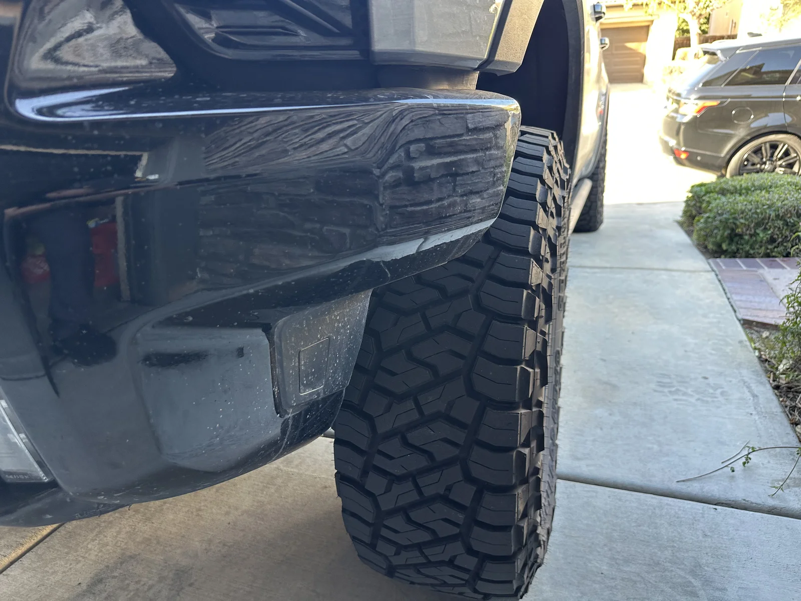

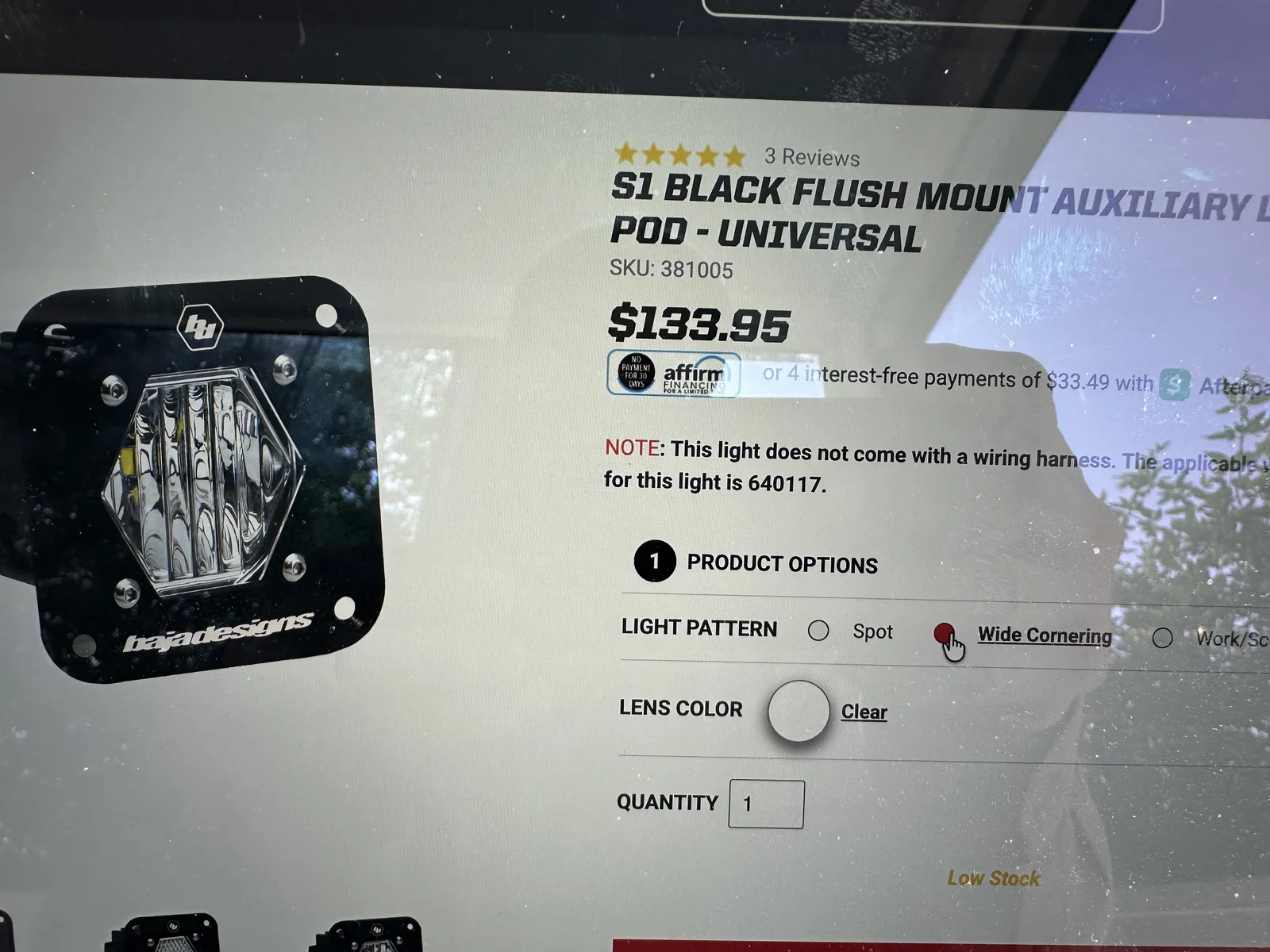

Took some time today to clear out a few cross pieces in the grill that were blocking the light bar, rewired the backlight to come on when I start the truck (piggybacked fuse 46) and in the next week or so going to instal some flush mount Baja S1's with a wide cornering lens in the front side bumper. After doing some descent night off-roading, realized how much I need true ditch lights aiming to the sides. Can't see the terrain when making turns so this should solve it. Have to cut out the end caps to fit them in. Will post pics when cutting and complete.
Nothing a cut off wheel can't fix!
Exactly!! Luckily there’s access when you pull the liner out the way.
