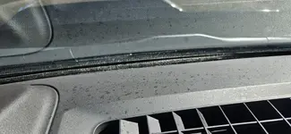

Today when I pulled my window shade from the dash, the foam rubber seal that sits below the dash and seals up the space between the windshield came out. It was stuck to the edge of the shade and it stretched out about 8 inches before I seen it. Kinda went back into the space, but looks to be roated a quarter turn and needs to be pressed in 5mm. Not sure there is a long term reliable fix, but I'm gonna try to straighten it out and tuck it in with a forceps tomorrow.
Once again, I'm left with the feeling these trucks have a lot of cheap materials in them.

I'd just pop that panel off to put the seal back. Not sure how it came off like that. Maybe the shade was pushed down into it and the heat and pressure caused the glue to come loose. That panel just pops off, but you have to take the A piller plastic off. Couple 10mm bolts hold them on.
Is the foam attached to the dash cover or the dash where it meets the windshield? Is that foam sticky on two sides? Seemed like it might have been.
I'm just gonna try and place it for now. I'm sure I'll have to order some new foam, but might just have the dealer do it.

I tried tucking it in place with a trim tool. I can get it down there a ways but it pops back up some. Foam sticks to trim tool more than the dash. GMs gonna have to fix this garbage, I'm not investing another minute.
I'm pretty sure the seal is stuck to the dash and that panel just sits on it. Its not sticky on the top. That dash piece isn't stuck down. That dash piece has tabs on the windshield side and clips on the cab side. Basically pop up the clips and pull back on the panel to take it out. Kind of like a battery door on electronics. Hooks in the front and snaps down in the back.
I think that's why I can't get it to restick. It's twisted and the sticky side is up and seems to grab my trim tool or the sun screen. Usually once they pull up, the adhesive is shot and probably needs a new piece of foam.
