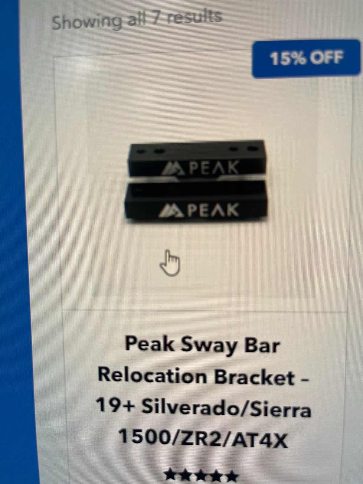

You won’t regret your purchase of the Dirt King UCAs. I have them and the Peak 2.25” lift. Consider getting the Peak sway bar brackets too, they keep the geometry correct.

Are these the brackets?

I just saw your additional post. Looking for these parts now.

Yep, those are the ones.
