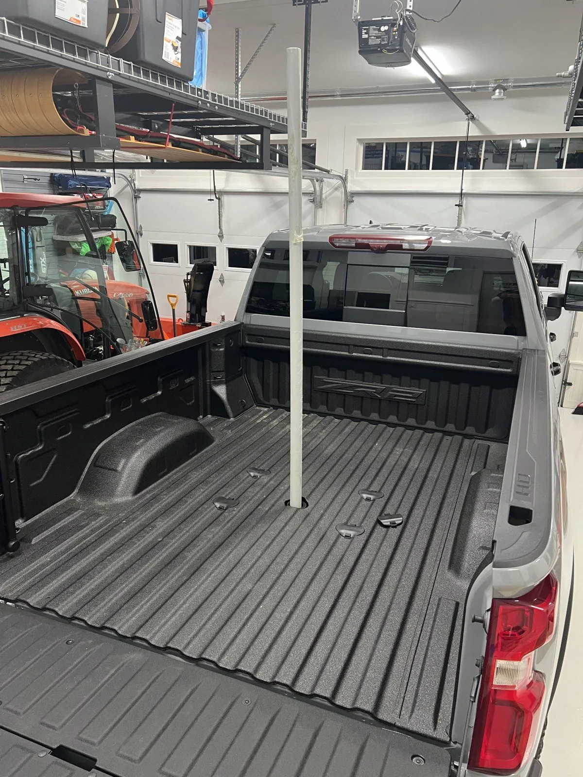

Installed the B&W BWGNRK1020 gooseneck hitch. Really not too bad other than being terrified to cut into your truck bed. I measured and remeasured for about four hours. After painting the bare metal, I added some grommets and metal edge trim for added protection. I was still able to use my bed mat and the cut out for the hitch fits perfectly back in place to keep the bed clear until you need the hitch. Also added a brush to cover the hole in the wheel well for the release lever. I think it turned out pretty good. I haven’t pulled anything yet but hope to this week.

Nice work. Had my local shop that does all my work I can’t or don’t have time to do (and has been tremendous over the years) put one my for me recently…hole was off a bit…got a 1/4” or so gap in the front of the ball. I wasn’t happy but what does a guy do at that point? The hole can’t be patched 😅 - i like your rubber trim approach, going to try that nd see if I can’t at least make it look a bit cleaner. Appreciate the post!

Thank you. What hitch do you have? The B&W has enough play were you could probably loosen and center the hitch to the hole. 1/4" is perfect for the metal trim, I cut my hole 4-1/4" instead 4" to accommodate it. Here's the link to the one I bought on Amazon, its really flexible and easy to work with.
