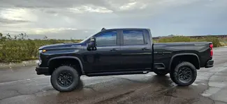

I have the AMP - Extreme version, with the ACCY switch. Those measurements are the same. The PowerSteps do not run from wheel well to wheel well like most rocker guards. My wife thanks me every time she get in the truck.

I have them on my 2500HD and the standard ones on the 1500. Unless you lift your 1500, they will sit quite low and the step will be close to the ground. I would stick with the standards.
They will not function like a rock slider. They may give you some light protection, but they will get crushed like a cochroach in any rugged terrain and you'll have damage to the steps and rocker panel.

I just had these installed this week. I really like them. They do come down lower than the original so I still have to pull myself in. Price you pay at 5'2".
The steps cost $1,900, and the installation was $300. The installation seems pretty straightforward. I think I could have done the installation myself, as they are considered plug-and-play, but I just didn't have the time.

They are not even close to plug n play. It requires running two separate harness and splicing wires into the BCM which is difficult at best to get to and even identify the wires that need to be spliced. I posted details on the install of the AMPs for both the 1500 and 2500.

I didn't do the installation myself. They scheduled me for five hours and took two, telling me they didn't realize they were the XL model and that supposedly those are an easier install.
There's 0 difference in install, I would say the XLs take a bit longer, cause your adding the XL housing which bolts in separately. I'd say it took me about 3 hours, but every lead on my wire harness is sleeved and secured to the vehicle. It takes a lot of time to do that cause there's probably 20+ feet of wire and 8 separate wires to all the parts.
