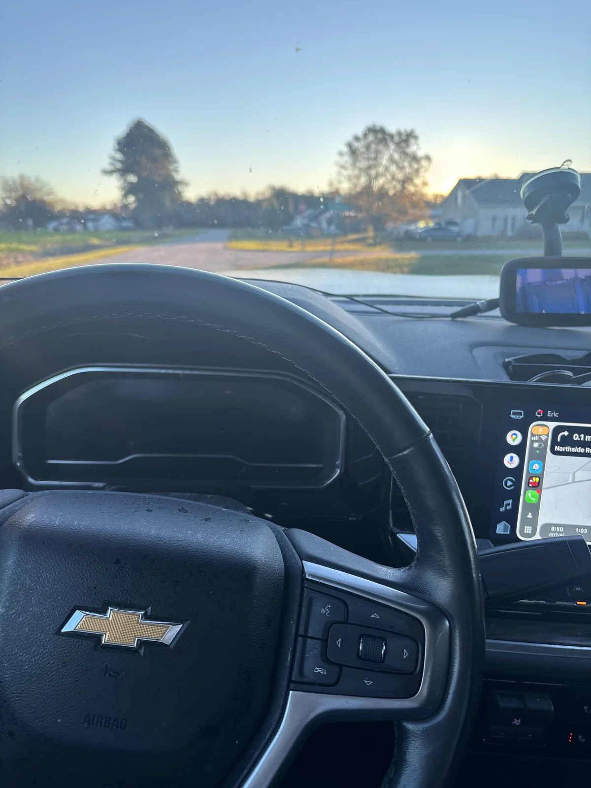

All,
Has anyone had any glitches with their main display (not infotainment display)?
Mine has been randomly dropping out since new, similar in fashion to the reverse camera issue (same style of glitch flickering rapidly and then just dropping out and going all black). Only way to bring the display back to life is to switch car off for a minute or two and restart, sometimes takes multiple attempts.
I had the camera issue fixed with a camera kit at the dealer (apparently a known fault/solution) hopeful the issues were connected but but no such luck with the main display as it still drops out randomly.
Trying to catch a video of it, hard when driving to do safely.... Does anyone know if this is a known fault? (or if there is a software patch/upgrade for it)
Also, have noticed a strange load electronic clicking coming from under the steering column just prior to the drop out, like a typewriter......

This issue is not a known issue. There is another issue that GM has yet to introduce a fix for where you lose the speed and tach display, but everything else displays fine. There is a bulletin on that one with a TBD fix.

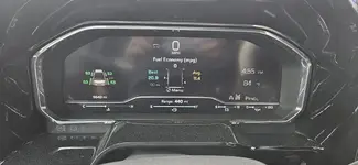

The issues may be linked, as when I first started having issues with the main display the speed and tach disappeared, and I managed to recover it by puling over and restarting. The dash went fully blank after that briefly and came back on. Is there a TSB number for the fault you mentioned re: Speed and tach disappearing? It would help my dealer....

Mine does exactly this every once in a while too. This is the TSB I was referring to above. Everything displays except for the speedo and tach. Not a show stopper by any means. However, GM is working on a fix.

I've had the issue with my tach and speed also glitching and not showing on my screen. To fix mine, I just go into the settings and select the screen configuration and it fixes the issue.
Been there...did that. It fixes it for a little while and then comes back. Like I said, GM stated there is no fix for this issue yet.
